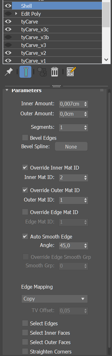

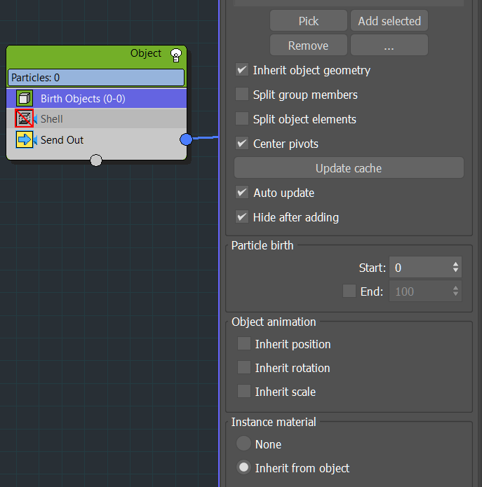

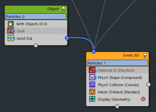

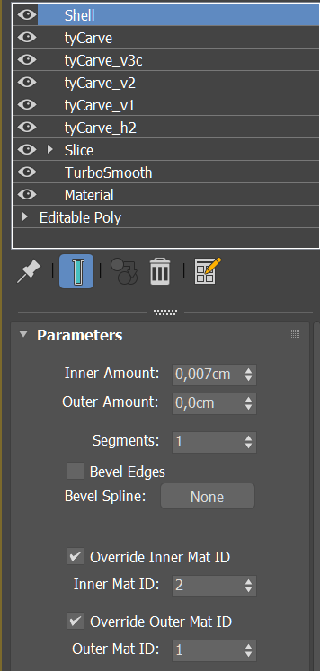

TyCarf lets Tyflow freeze (v1.023) - Alexx31 - 07-29-2023 Hello, I have some issues with a simple triangulated sphere and tyCarf. When I add it to a birth node, 3dsMax2022 is completely freezing/crashing. Tried in many different was to load it. Now I after an hour found out, that the 3dsMax Shell Modifier is not compatibel ;-/ It works when using Tyflow shell operator instead. Another screenshot below.... RE: TyCarf lets Tyflow freeze (v1.023) - tyFlow - 07-29-2023 Please upload the file with steps to reproduce the issue. RE: TyCarf lets Tyflow freeze (v1.023) - Alexx31 - 07-29-2023 (07-29-2023, 02:00 PM)tyFlow Wrote: Please upload the file with steps to reproduce the issue. Thanks, I'm preparing and sending by email soon. |
