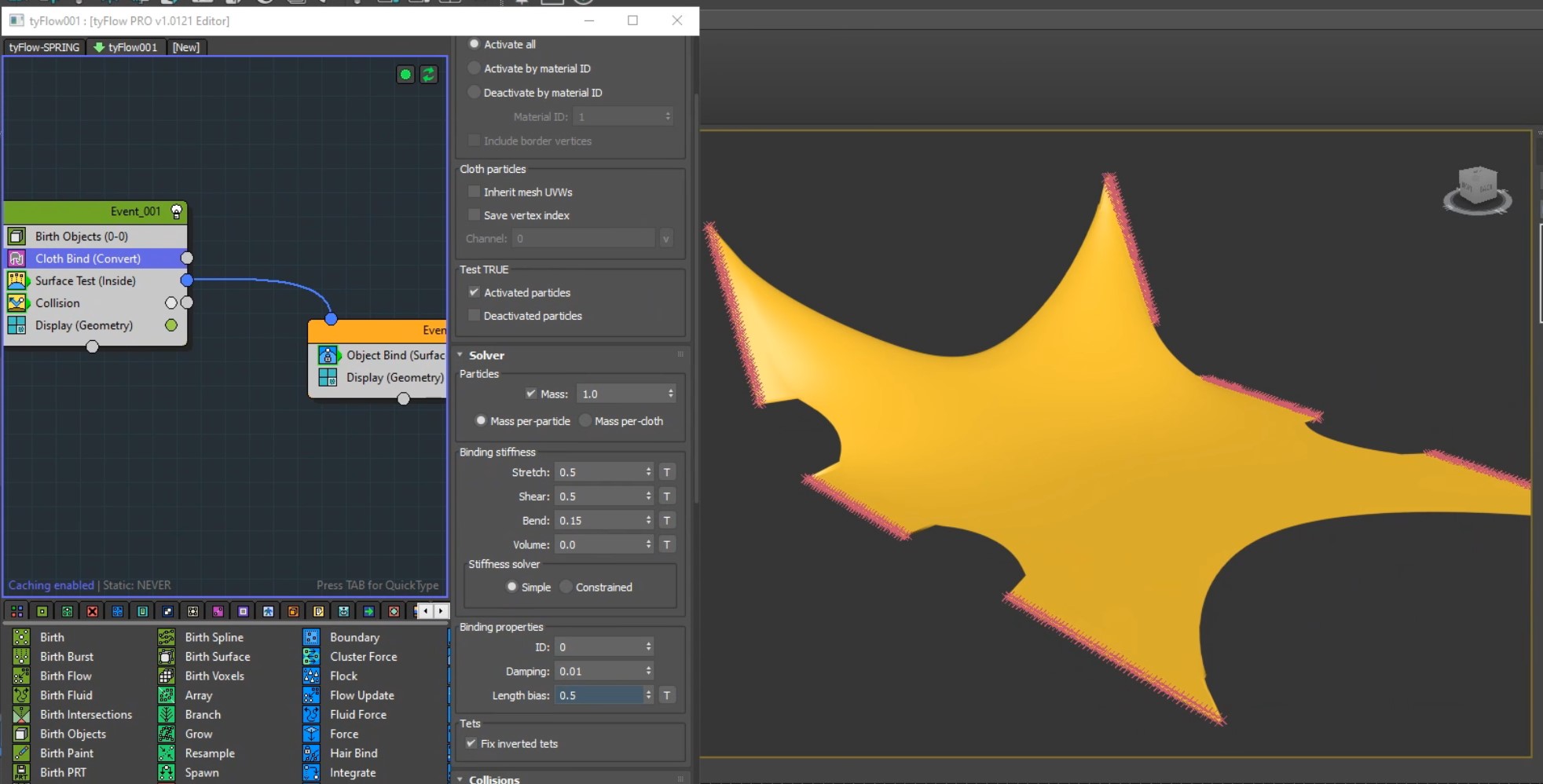

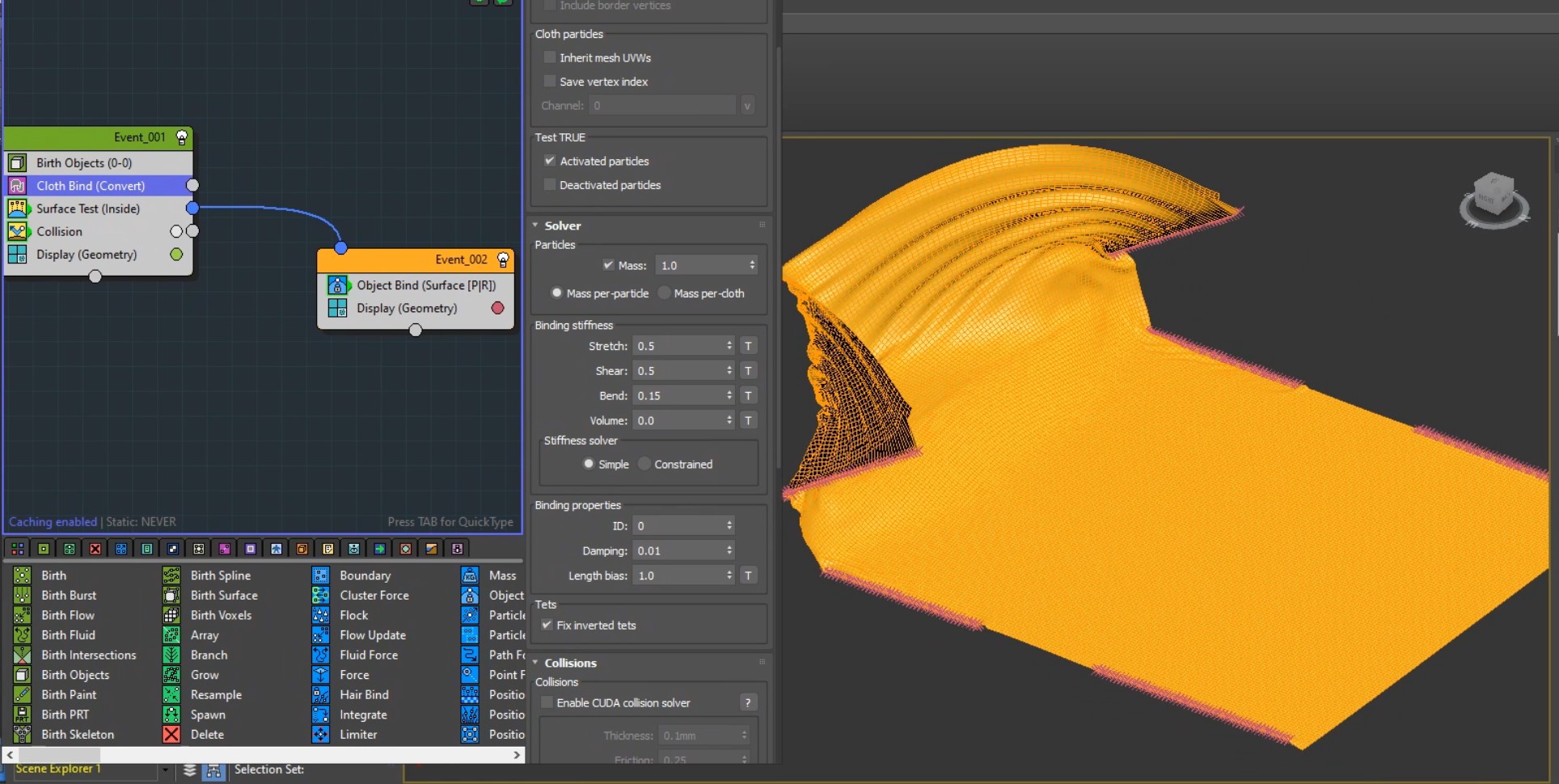

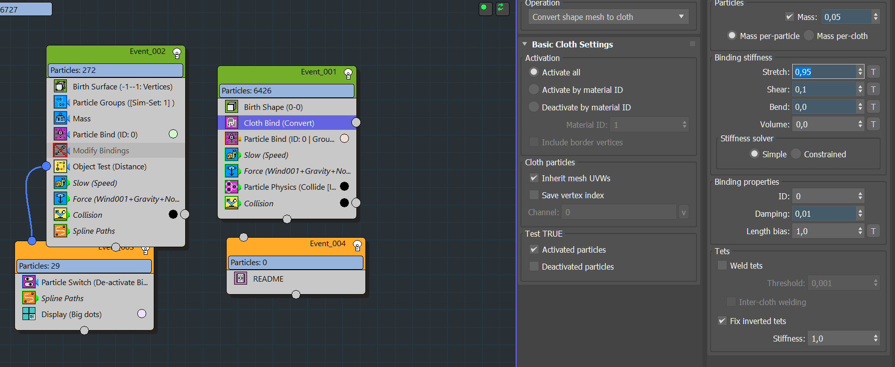

Excessive cloth stretching - VoiTech - 07-30-2023 Good morning everyone! I`m having issue with cloth simulation that is bothering me for a while now.... I want to simulate cloth that is connected in 6 points (all corners, and two points in the middle of the longer sides). My goal is to animate a cloth that is folding itself, but whatever sertting I am using, the cloth is geting stretched excessively. Is there a way to better control the stretchiness? I have tried all variations of settings in Cloth Bind node, set time steps to max, tried with CUDA collider and still nothing... My main goal is to have that fabric stretched between anchor points so it will be almost flat, and the cloth bending only where it is supposed to bend (with slight influence of gravity for whole objerct) What are your settings for this kind of simulation? RE: Excessive cloth stretching - Alexx31 - 07-30-2023 (07-30-2023, 07:47 AM)VoiTech Wrote: What are your settings for this kind of simulation? Hello, did you compare the example files of tyflow? as "tyflow flag" There is a "flag" example with "read me" explanation And your cloth stiffness isn't really high: The maximum value is 2! The flag example has 0,95 Maybe also more Damping. Maybe it's closer to a "paper fold" simulation, just for a different approach to search tutorials. (But I'm no cloth expert...; ) RE: Excessive cloth stretching - VoiTech - 07-31-2023 (07-30-2023, 12:15 PM)Alexx31 Wrote:(07-30-2023, 07:47 AM)VoiTech Wrote: What are your settings for this kind of simulation? RE: Excessive cloth stretching - Alexx31 - 07-31-2023 (07-31-2023, 07:12 AM)VoiTech Wrote:- I think, you need not only two small points for dragging, you need a complete line, which is stabilizing the area where you drag the cloth.(07-30-2023, 12:15 PM)Alexx31 Wrote:(07-30-2023, 07:47 AM)VoiTech Wrote: What are your settings for this kind of simulation? And another line where the fold should crease. With a soft binding (springs). I would google for any cloth folding tutorials, because the general technique is independent from the tool. - If that doesn't work, you could bind cloth to a mesh, which is rigged, then you get full control (but don't ask me about the settings and exact workflow). https://www.youtube.com/watch?v=FfXcEPL5zGY - Ask in the Facebook Forum. Show your setup but also show an example of what you would like to achieve. I am pretty sure that someone has once done a cloth folding animation. The topic is interesting for everyone... |
