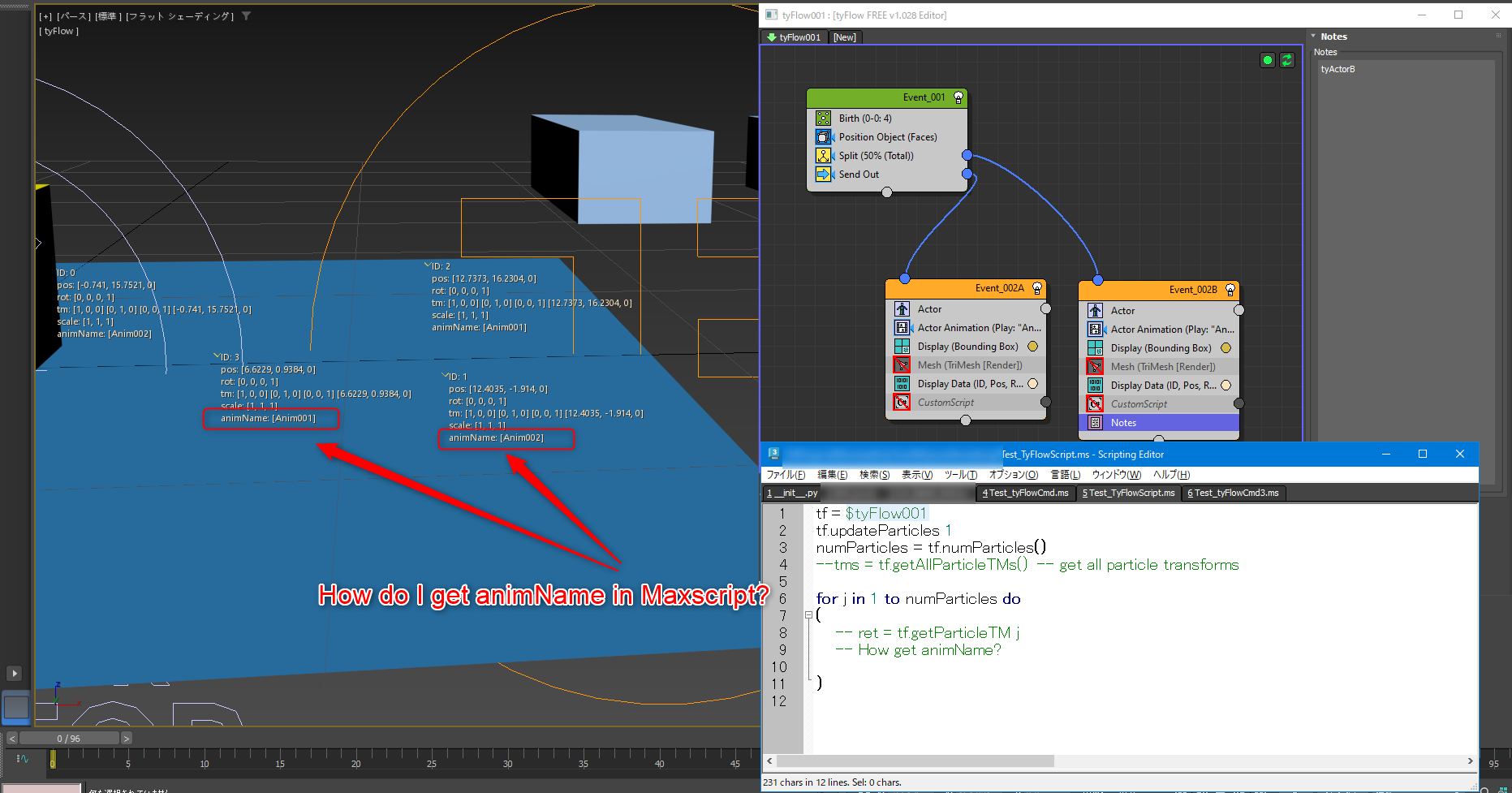

Is it possible to get AnimName with Maxscript? - KunihiroSakai - 12-26-2023 Hello everybody. I'm looking for a way to outpu DisplayData information about particles generated in 3DS Max 2023. Is it possible to get the AnimName displayed in DisplayData using Maxscript? RE: Is it possible to get AnimName with Maxscript? - tyFlow - 12-30-2023 Not with MAXScript, no. You could read the name of the animation by examining the relevant string property in the Actor Animation operator, but depending on your settings that doesn't mean the animation listed there is the current one being played on a particle. RE: Is it possible to get AnimName with Maxscript? - KunihiroSakai - 01-09-2024 (12-30-2023, 05:13 AM)tyFlow Wrote: Not with MAXScript, no.Hello tyFlow. Thank you for your feedback. Is it possible using C# script? |
