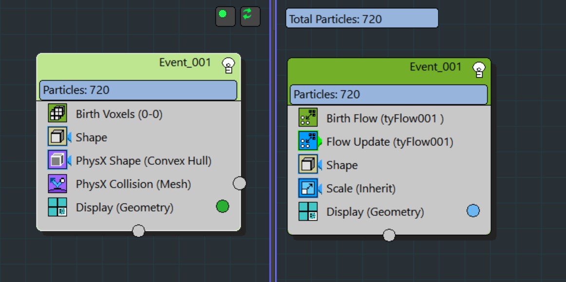

replace low res geo with high res - ldotchopz - 01-15-2024 Doing a ball simulation and trying to replace the low res spheres with high res sphere models. I thought this could be done by using a birth flow and flow update, and change the shape to high res, but the birth flow event shows the high res spheres for the first frame and then changes to the original low res spheres after the first frame of animation. Is there something i am missing? Thanks RE: replace low res geo with high res - tyFlow - 01-16-2024 Disable shape update in the Flow Update operator. RE: replace low res geo with high res - ldotchopz - 01-16-2024 Ah yes perfect, thanks! I completely missed that. |
