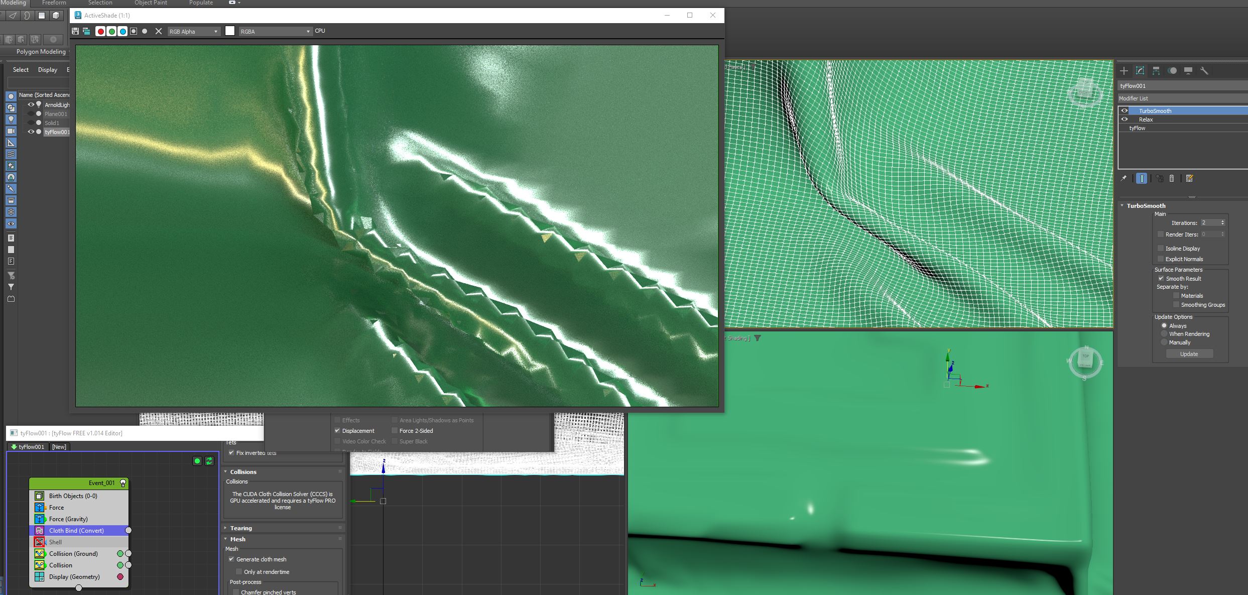

Turbosmooth not rendering? - GreenDK - 01-18-2024 Hi all. I am fiddeling with some cloth simulation and it seems to work fine. However when I render the cloth, using Arnold, it looks jagged compared to the viewport. Almost like the Turbosmooth is not being registrered by the render? When I take a mesh snapshot of a single frame and render it, there is no problem. Not sure if it is a tyFlow problem tho? Just never seen it before. Anybody know whats going on? Ps. using free tyFlow and 3DS Max 2023. RE: Turbosmooth not rendering? - tyFlow - 01-18-2024 Turbosmooth has some known issues that can pop up from time to time....try the Meshsmooth modifier instead. RE: Turbosmooth not rendering? - GreenDK - 01-19-2024 (01-18-2024, 02:56 PM)tyFlow Wrote: Turbosmooth has some known issues that can pop up from time to time....try the Meshsmooth modifier instead. Fair enough. I will try to work around it. Thank you, Tyson. RE: Turbosmooth not rendering? - Aleksandr - 03-07-2024 With meshsmooth same. And with relax same. Not working with Arnold renderer |
