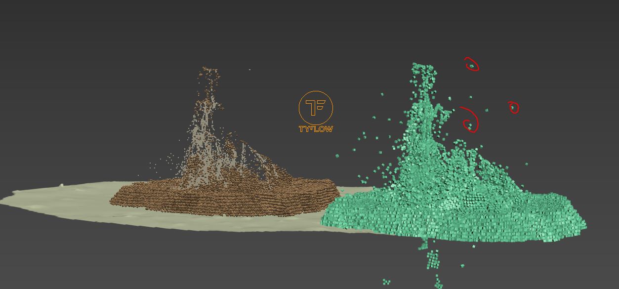

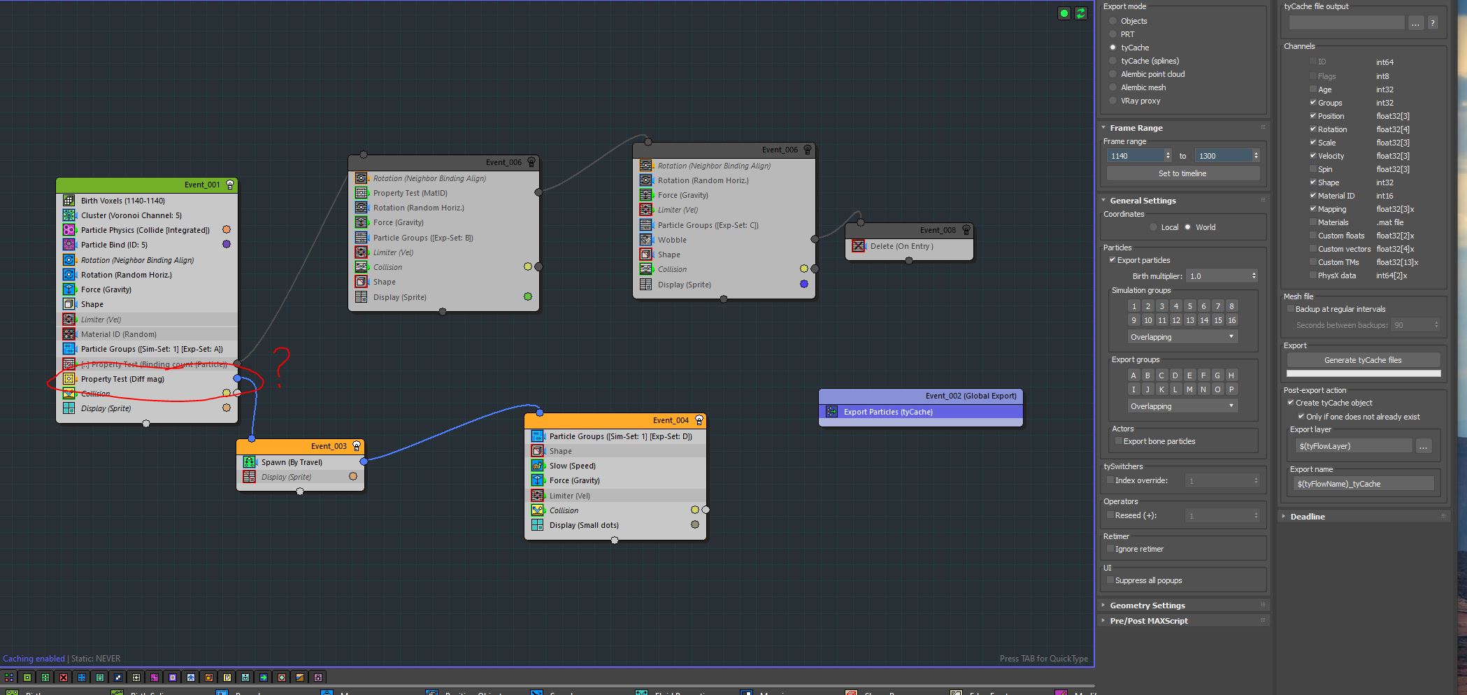

exported TyCache doesn't match the flow sim - john.zi - 03-01-2024 Hi, so I've been struggling with this issue for a while now and it give me a real headache. I am simulating some grains plus spawning some extra sand from them using property Test (Diff mag). In general when I got to the point that I am happy with the results in the viewport I am trying to export it to TyCache or PRT. Unfortunately the caches which I am generating doesn't look the same as the sim in the viewport. I get bunch of random particles floating and going upwards like there is no gravity. In this example below maybe there are not that many of then but when I significantly increase the number of grains the difference is more striking. Also I've noticed when I disable Property Test (Diff mag ) where I spawning new particles, then Tycache is more consistent with what I see in the viewport. I was trying to cull those particles using the volume but I guess there must be another way that I am not aware of. Did anybody experience anything like this I know how to solve it? Thanks ! RE: exported TyCache doesn't match the flow sim - tyFlow - 03-01-2024 You have the Display operator in event_003 disabled, but your Export Particles operator is in a global event (blue)...so those particles are not displayed, but they're being exported. Put your Export Particles operator in event_001, then copy + paste it (instanced) into event_004. Then export - by excluding event_003 (and not having it in a global event) it'll only export particles in the events that you want. RE: exported TyCache doesn't match the flow sim - john.zi - 03-02-2024 Amazing, It works! I don't know how could I miss it. Thank you very much ! |
