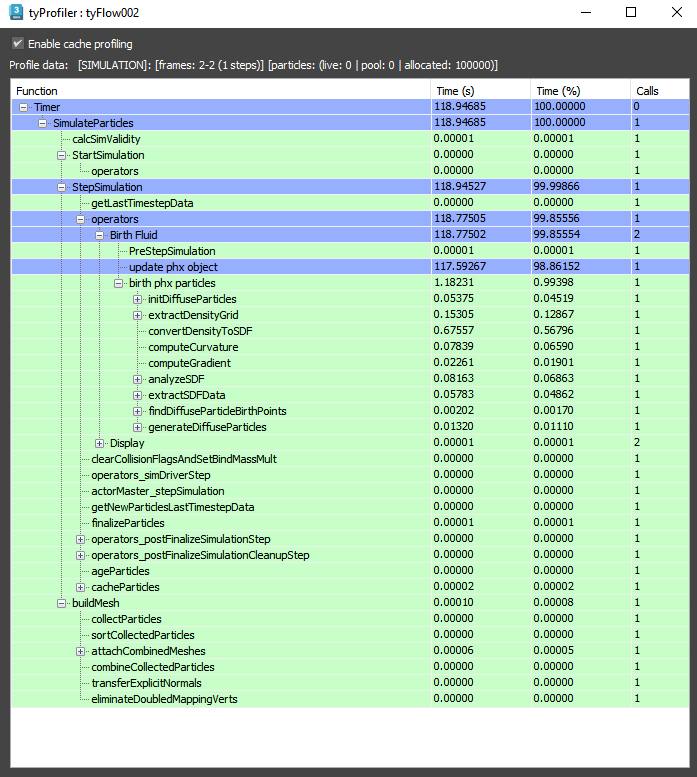

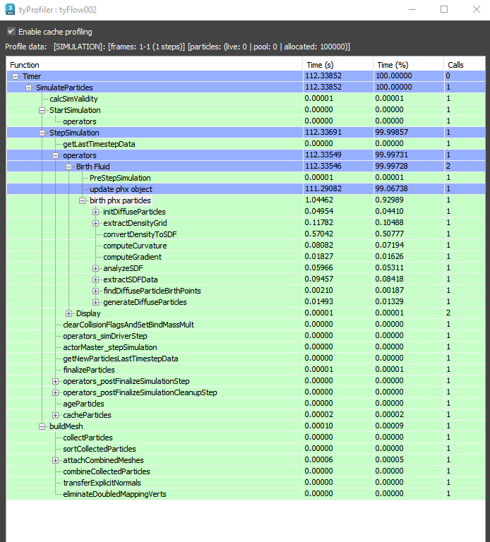

RE: generate spray,foam extremelly slow - v.p.vlasenko - 05-26-2024
Hi, here is a screenshot.
For some reason one of the sims(beach waves from chaos) today worked just fine, while nothing changed.
This one is still too slow, but it is even simpler - 3,8M cells.
RE: generate spray,foam extremelly slow - tyFlow - 05-26-2024
Hmm, so the slowdown is occurring when tyFlow is just updating the Phoenix object (calling Phoenix's own functions). The actual work being done in the Birth Fluid operator is not the cause of the slowdown.
To further debug this I would need access to the cache and your scene. If you want to zip it up and send it over to support@tyflow.com I can see if there are any other clues that might explain what's going on.
