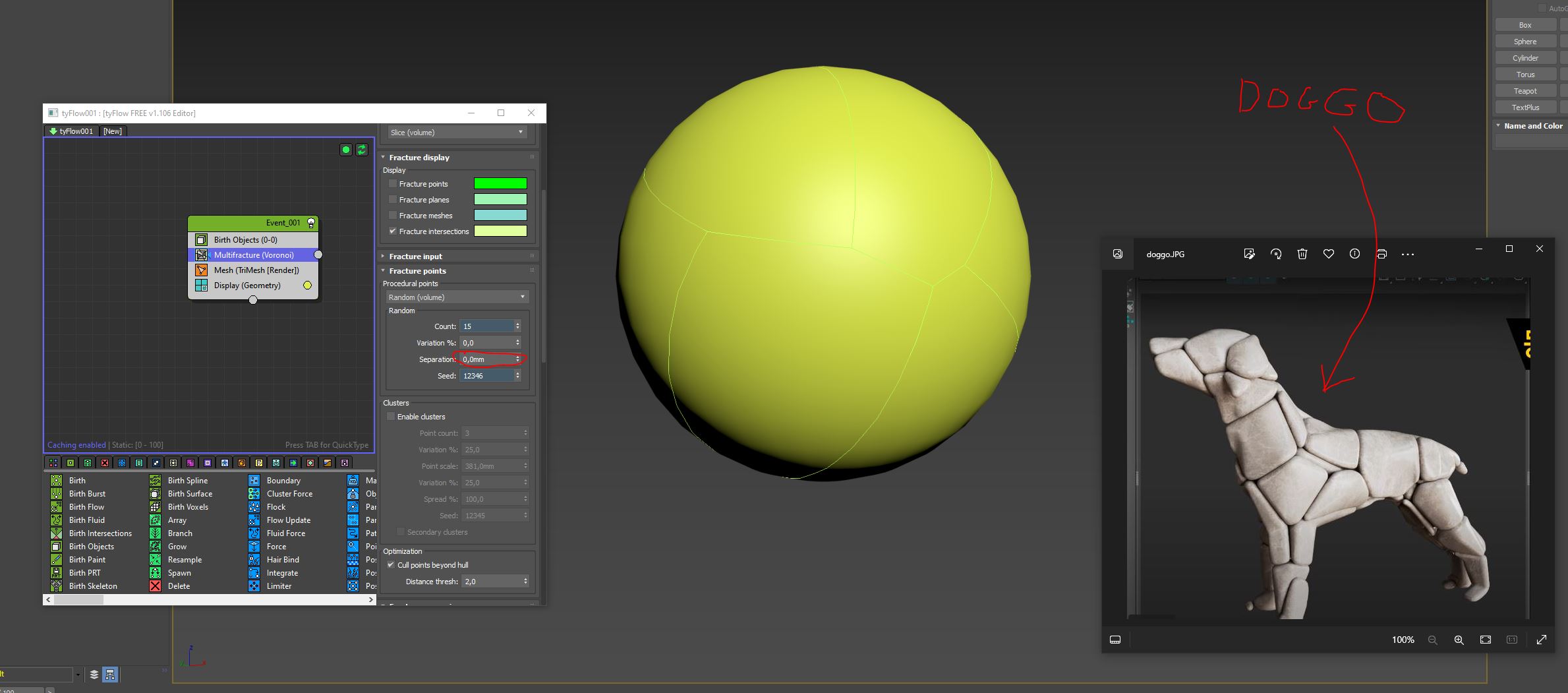

In voronoi fracture you could add some space between the fractures with separation setting.
How does that work in Multifracture?
The Separation setting does not work that way?
Say I wanna make something lige Doggo in the image below
How would I do that in Multifracture?

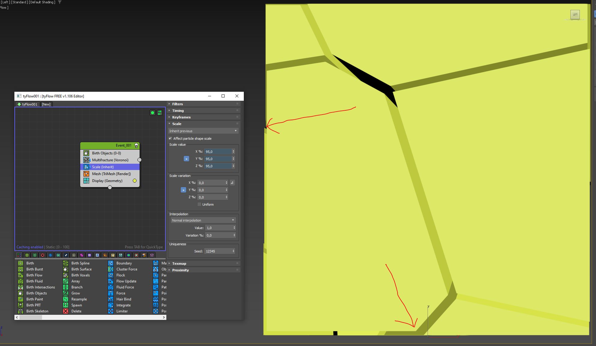

Using scale makes fractures look "uneven" (image)

RE: Separation in Multifracture? - tyFlow - 06-25-2024
For multifracture, you can set the operation to "subtract" and increase the shell value for fracture meshes.
RE: Separation in Multifracture? - GreenDK - 06-26-2024
(06-25-2024, 03:00 PM)tyFlow Wrote: For multifracture, you can set the operation to "subtract" and increase the shell value for fracture meshes.
Thank you.
That works Smile
