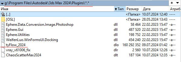

3DMax doesn't see TYFLOW - PlusSorok - 07-10-2024 Good day to all. I had this problem: I didn't have enough space on the hard drive "C", so I had to install 3Ds Max 2024 on the drive "D", but now when I move tyFlow _2024 to the Plugins folder, 3DMax doesn't see it. There are no errors. 3Ds Max works normally, whether it would be tyFlow is not installed. Can you help me with this? RE: 3DMax doesn't see TYFLOW - tyFlow - 07-10-2024 What happens if you navigate to Customize > Plugin-in Manager > right-click > Load new plugin > select tyFlow_2024.dlo? RE: 3DMax doesn't see TYFLOW - PlusSorok - 07-10-2024 (07-10-2024, 12:51 PM)tyFlow Wrote: What happens if you navigate to Customize > Plugin-in Manager > right-click > Load new plugin > select tyFlow_2024.dlo? Oh =) Yes, this solved my problem)) Thank you for your prompt help. ![]() RE: 3DMax doesn't see TYFLOW - tyFlow - 07-10-2024 Odd...could be a Max configuration issue preventing Max from seeing your plugins folder...hard to say. At least it loads from the plugin manager. |
