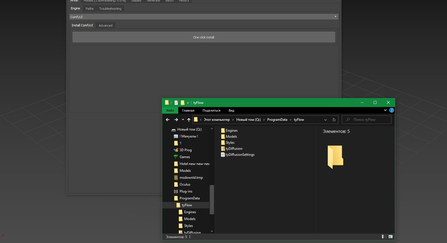

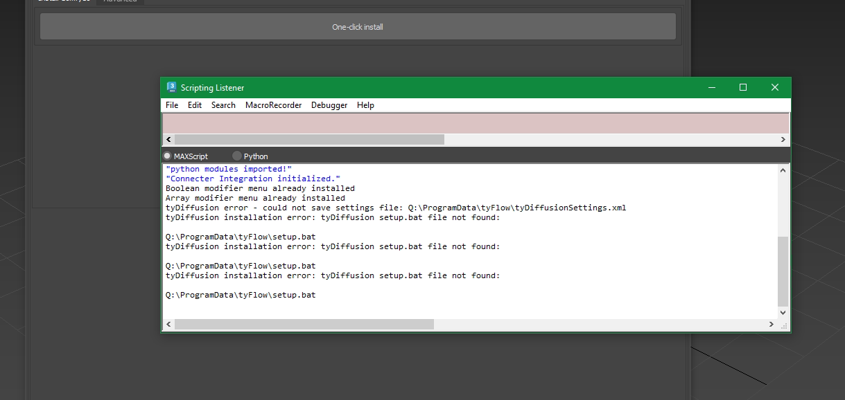

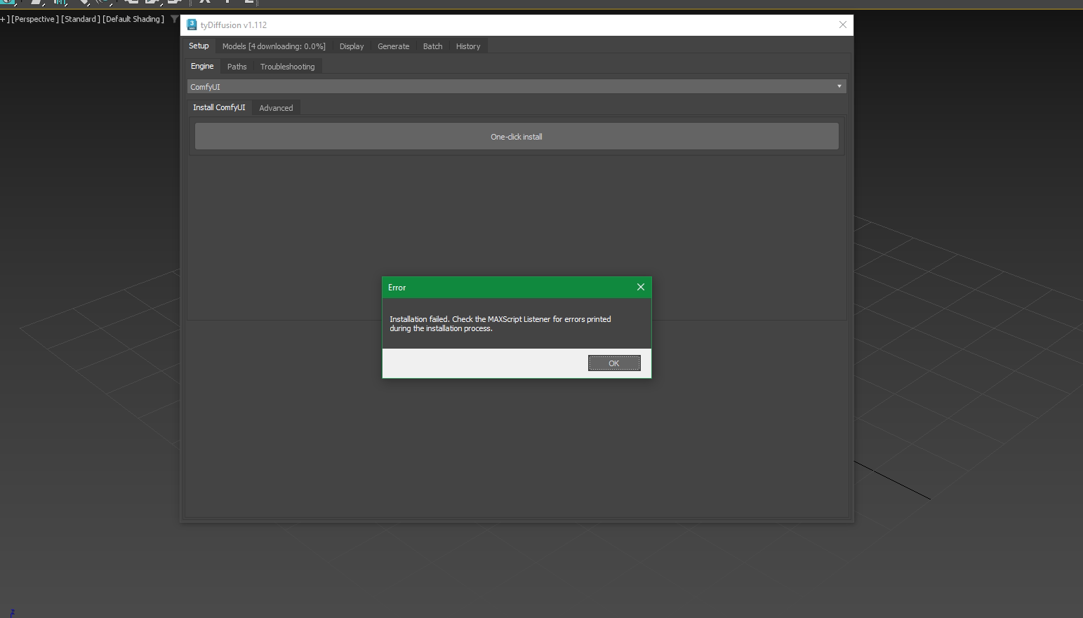

tyDiffusion setup.bat ERROR - PlusSorok - 07-20-2024 Good day, friends =) In general, so, I have a problem. I installed tyFlow for myself, and it does not allow me to install AI. I saw that there was already a similar problem here, but the solution didn't help me, although I may have done something wrong. I must say right away that I tried installing everything on the C drive for the test, but this does not change the situation in any way. You said that you can start the installation manually, can you explain in more detail how to do this? Because I don't have a "TyDiffusion" folder that doesn't want to be unzipped. Please help me ))) my whole problem is in four files) RE: tyDiffusion setup.bat ERROR - tyFlow - 07-20-2024 Seems like the zip file used to extract tyDiffusion assets cannot be created due to a possible permissions issue in your target folder. Please make sure the target folder is configured so that your Windows user has read/write/execute permissions. Alternatively you can try running 3ds Max as administrator prior to running the one-click installer. |
