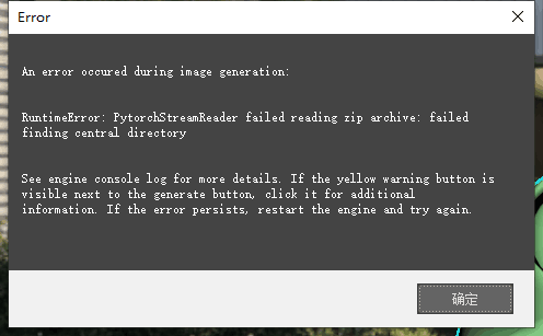

RuntimeError:PytorehStreamReader failed reading zip archive: - Finley_fang - 08-05-2024 [附件=3667]After creating the model and clicking on Generate this window will pop up, and in the case of an empty scene it will be able to generate the image content normally. RE: RuntimeError:PytorehStreamReader failed reading zip archive: - tyFlow - 08-05-2024 The ComfyUI console window will display extra info about this error when it occurs. Please copy + paste that as well. RE: RuntimeError:PytorehStreamReader failed reading zip archive: - Finley_fang - 08-06-2024 (08-05-2024, 08:27 PM)tyFlow Wrote: The ComfyUI console window will display extra info about this error when it occurs. Please copy + paste that as well. Is this it? It seems to be a problem with the depth, I reselected the type of depth and it's working fine now! RE: RuntimeError:PytorehStreamReader failed reading zip archive: - tyFlow - 08-06-2024 Hmm, interesting. The "depth anything" preprocessor is looking in the path above the error message (D:\Program Files...") for the model. That's not the standard location for depth preprocessor models, and putting things in the program files directory can result in various permissions issues, depending on your Windows settings. Does the model file it lists exist in that path? Is that the same path you configured your other models to go in? RE: RuntimeError:PytorehStreamReader failed reading zip archive: - Finley_fang - 08-06-2024 Yes, the model files were too big, so I configured all the model files to another storage location |
