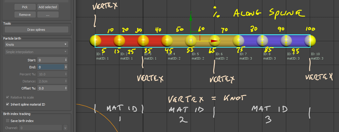

Bug or Expected Behavior - Birth Spline ? - rjanders0003 - 09-06-2024 G'Day Tyson If you create a spline with 3 segments. Then assign a material ID to each segment (1,2,3). If you select Inherit Spline Material ID, the whole spline only gets the 1st's segments material ID applied to the whole spline. IE: if the material ID of first segment is 1 then 1 is assigned to whole spline, if 4 then 4 is assigned to whole spline. is this normal assignment of materials or should they match each segments set id ? Thanks Mate Rob Correction to behavior - I just noticed the above is only true in Percent along spline and distance along spline in knots mode the material ID is set as per original material assignment RE: Bug or Expected Behavior - Birth Spline ? - tyFlow - 09-06-2024 Hmm, I'll make a note to look into this. |
