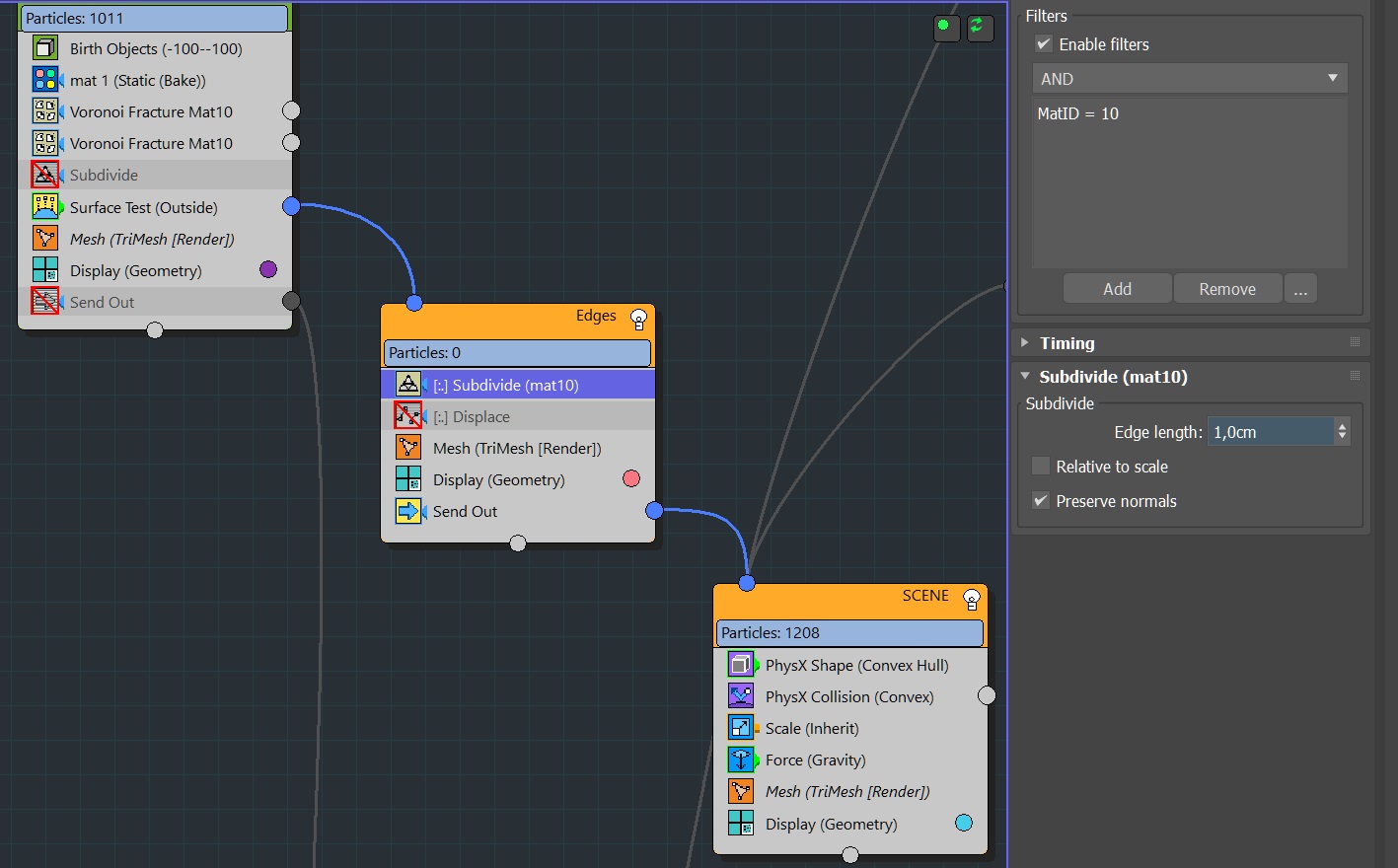

Filter by Mat ID not working - Alexx31 - 09-23-2024 Hello, I want to subdivide only inner faces and filter them by mat ID, why is it not working? When I disable the filter everything is subdivided (as expected). The Material ID in the voronoi fractures is set to 10. Thanks for help RE: Filter by Mat ID not working - tyFlow - 09-23-2024 That tests matID overrides applied to particles, not matIDs applied to mesh faces. RE: Filter by Mat ID not working - Alexx31 - 09-23-2024 Ok thanks, found the proper setting now. |
