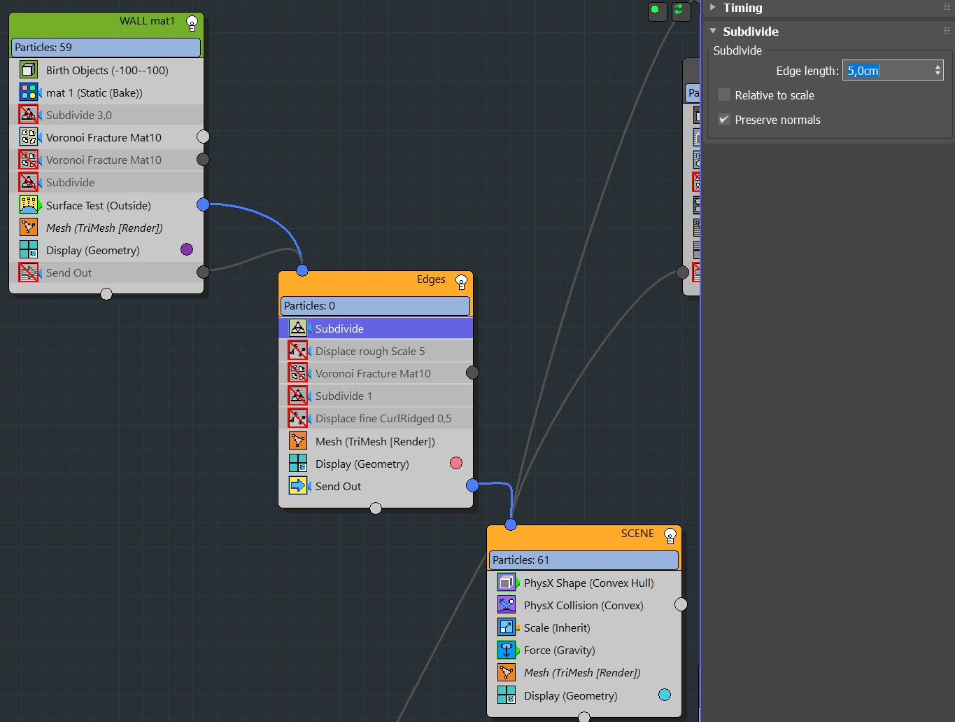

Subdivide is messing up material ID - Alexx31 - 09-23-2024 Hello, when I subvdivide, then the material ID of the inner faces jumps at some particles also at the outer side. How can I prevent that? Tried all settings in the subdiv operator. (When breaking it should keep the main material outside of course.) Thanks RE: Subdivide is messing up material ID - tyFlow - 09-23-2024 I just use Max's own subdivide functions for that operator, so if issues like that are occurring, then it's a bug inside Max itself. Eventually I may rewrite the subdivide functions with my own. RE: Subdivide is messing up material ID - Alexx31 - 09-23-2024 Thanks for reply! I will work around but can send you the file in case it's interesting. RE: Subdivide is messing up material ID - Alexx31 - 10-12-2024 Just wanted to mention, I had sent you the file and would be great if you could rewrite sometime. In my current project I was now able to use it with a workaround and subdividing helped getting a clear improvement. |
