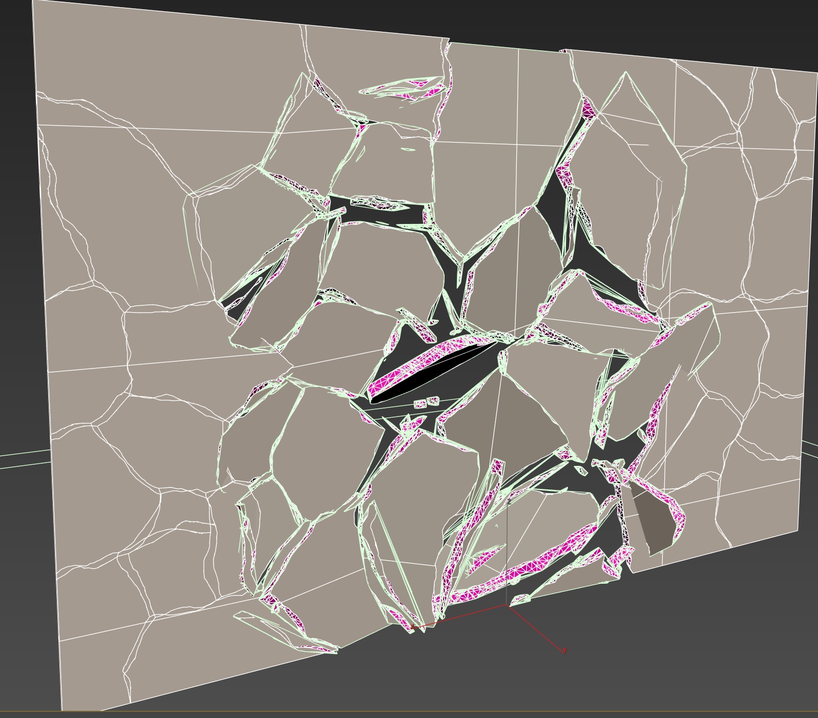

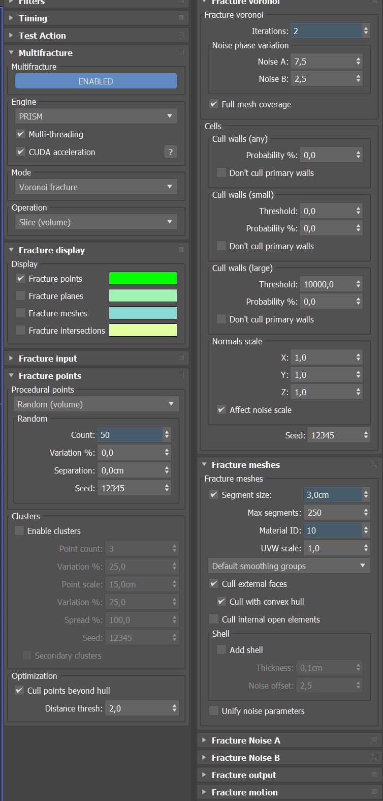

How not getting my mesh exploding with Multifracture and PhysX shape - Alexx31 - 09-23-2024 Hello, testing the new Multifracture I'm getting immediately an exploding mesh (from penetration for sure). I have set the penetration offset already very low (-1cm). ( And "Ignore starting penetrations" made also no difference) Then I tried also operation "subtract volume", which is far easier to handle, but produces immediately visible rifts. I need these cracks to be invisible before falling apart. What can I do else? Thanks RE: How not getting my mesh exploding with Multifracture and PhysX shape - tyFlow - 09-23-2024 Not sure why you've set your PhysX Shape operator timing to continuous, but that's likely the problem. Use "sticky starting penetrations" rather than "ignore starting penetrations". |
