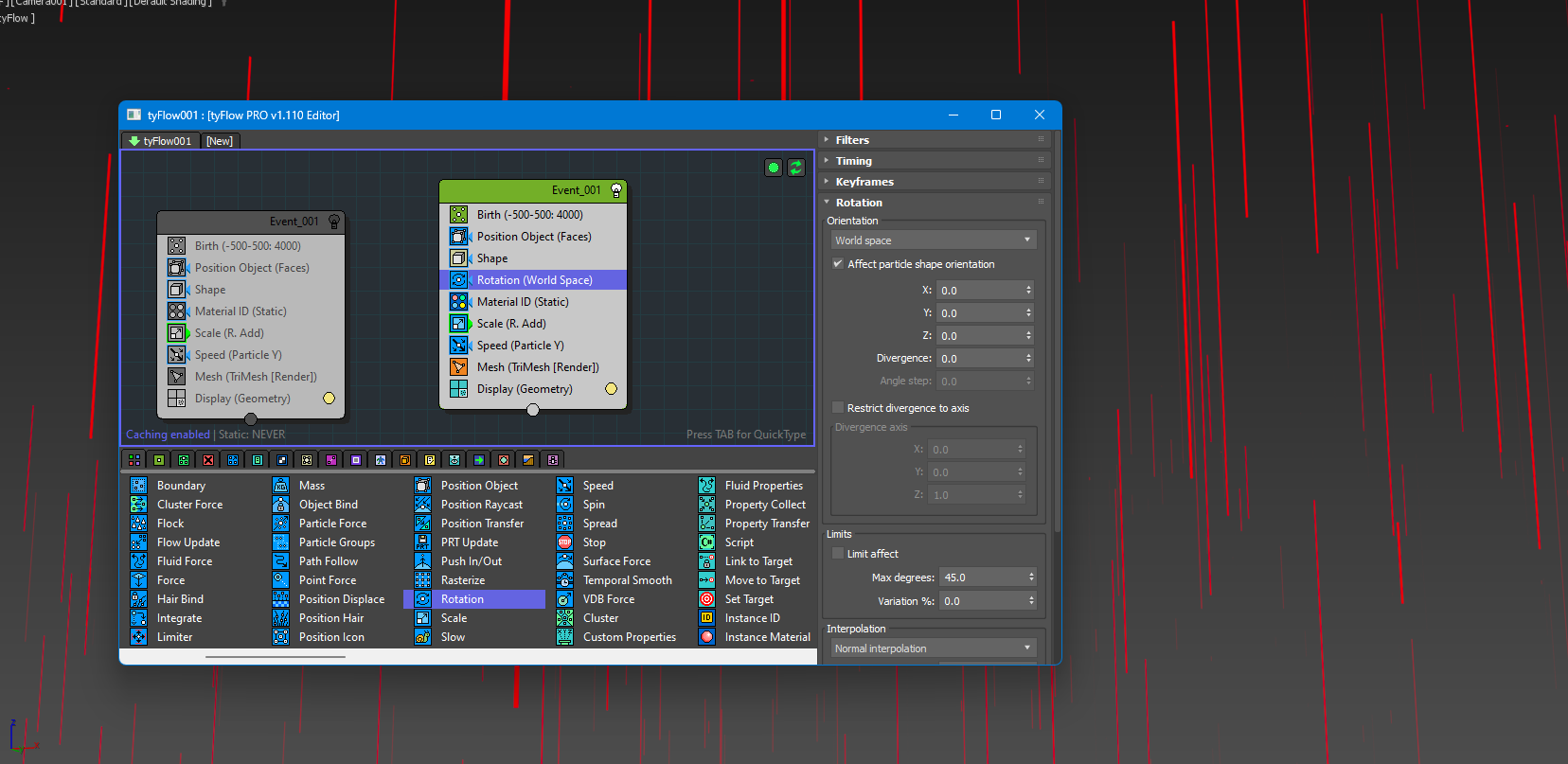

Rotate Particles From Birth? - Chrissonator - 10-09-2024 I simply want to rotate the red particles 90 degrees so they are long ways towards and away from the camera instead of up and down, but when I use the rotate operator, it doesn't produce the results I want... what am I missing? RE: Rotate Particles From Birth? - tyFlow - 10-12-2024 Use look-at mode and choose your camera. Then adjust the rotation X/Y/Z parameters accordingly. |
