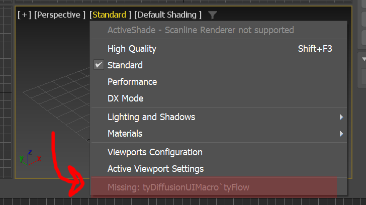

TyDiffusion UI macro - Pat_1957 - 10-30-2024 Hi guys , not here often , i usualy get my answers by searching but this one ..... Nop ! I ''don't know what i did'' accidently lost TyDiffusionUI ( see picture ) . How to get it back ? Great big THANKS for your help . A lost retired ... ? RE: TyDiffusion UI macro - tyFlow - 10-30-2024 What version of Max are you using? I've seen a couple of people run into that issue, and I'm not sure what the cause is. Either way, the solution appears to be to reset your ENU folder. Rename this folder to ENU_backup and then restart Max: Code: C:\Users\[YOUR USERNAME]\AppData\Local\Autodesk\3dsMax\[YOUR 3DS MAX VERSION]\ENURE: TyDiffusion UI macro - Pat_1957 - 10-31-2024 3DS MAX VERSION ..... 2024.2 RE: TyDiffusion UI macro - Pat_1957 - 11-02-2024 Still the same message even if i came back to v1.112 for the install . Missing ''TyDiffusionUIMacro 'TyFlow'' Forget what said above . New install made it work . I |
