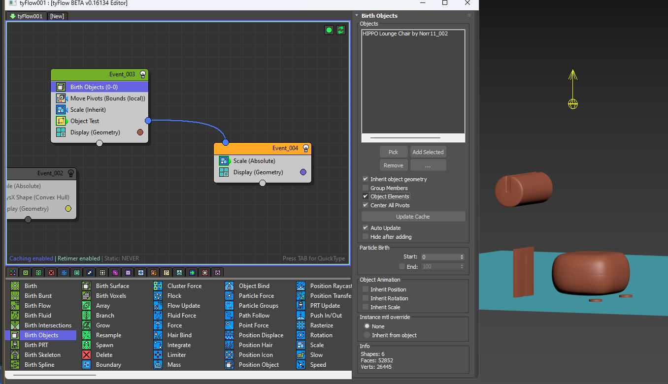

Birth Object - wallee - 12-04-2024 hi guys, after adding object to Birthobjects, the objects is rotated 180 degrees...did some one knows if im doing some thing wrong? any one got the same issues... by the way if i activate Object elements in object panel, the object rotate in its original coordinate, but the objects is messy. (there is no group or sub element, the object is a collapsed chair). im using both version 1.2 free and beta V0.16...same result... Thanks in advance. RE: Birth Object - d4rk3lf - 12-04-2024 You probably need to reset X-Form to the original objects. RE: Birth Object - tonightfee - 12-09-2024 I think you should change it back to the way it was before adding the object to Birthobjects |
