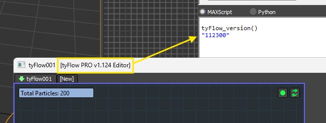

"tyFlow_version()" returns incorrect version? - betamax - 02-28-2025 Heya Tyson,just letting you know that we installed 1124 and and using the mxs tyFlow_version() returns 1123 in the listener. Thanks, Max RE: "tyFlow_version()" returns incorrect version? - tyFlow - 02-28-2025 Are you sure the 1.124 DLO copied over correctly? I tried just now and the MXS function returns the correct value... RE: "tyFlow_version()" returns incorrect version? - betamax - 02-28-2025 Hmm def saying the wrong thing, even though 1124 is loading correctly. We use env vars to centrally load tyFlow when Max is loaded, maybe that's the issue here? RE: "tyFlow_version()" returns incorrect version? - tyFlow - 02-28-2025 Do you have tyFlow RENDER installed as well? Is that still on v1.123? RE: "tyFlow_version()" returns incorrect version? - betamax - 02-28-2025 (02-28-2025, 03:19 PM)tyFlow Wrote: Do you have tyFlow RENDER installed as well? Is that still on v1.123? Thank you, bang on - that was it! Much appreciated. |
