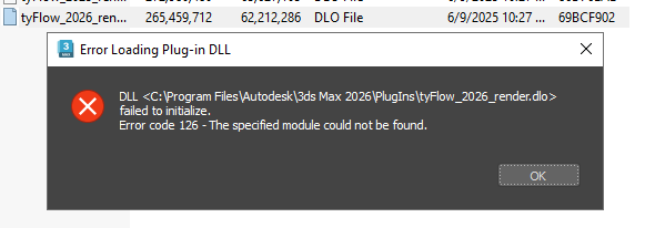

Hi Tyson, I'm running across an issue with installing tyflow_2026_Render.dlo on the farm nodes.  I'm getting the 126 - error on startup.  The latest vc_redist packages are installed.  The previous 1.127 2026_render.dlo (6/2/25) worked.  When installed the newest update 1.128 2026_render.dlo (6/9/25), I get the error.  These machines are cpu render farm only with onboard gpu if that makes a difference.

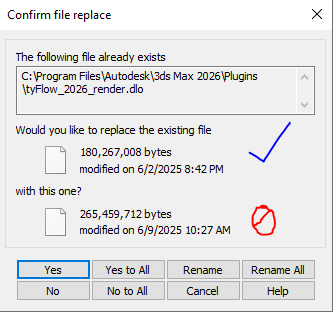

Here is a screen of the error and file dates/versions replacing the 2026 render.dlo (6/2 with the 6/9).  Another issue is that the previous 2024_Render.dlo also worked, now the updated 2024_render.dlo (6/9) does not and also throws a 126 error.
The 1.128 2026_Render.dlo and tyflow_2026.dlo (6/9) both work fine on my local machine.  The only difference I can see as a non system admin for the farm is the lack of a dedicated gpu on the render node.  But the previous versions worked fine without a gfx card as well.

Thanks for letting me know - please redownload v1.128 and see if the problem is resolved (I updated the DLOs with a potential fix).

Latest release builds against PhysX CUDA static libraries, but I forgot to add nvcuda.dll to the list of delay-load DLLs for machines that don't have CUDA DLLs installed. Without the fix, Max looks for nvcuda.dll during startup and shows error 136 if it can't find it - the update fixes that.
