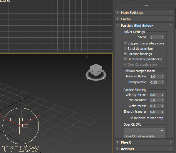

for some reason opencl is not available in tyflow . option is faded and in new 16015 version the selection drop-down  mentions " opencl Not Vailable "
