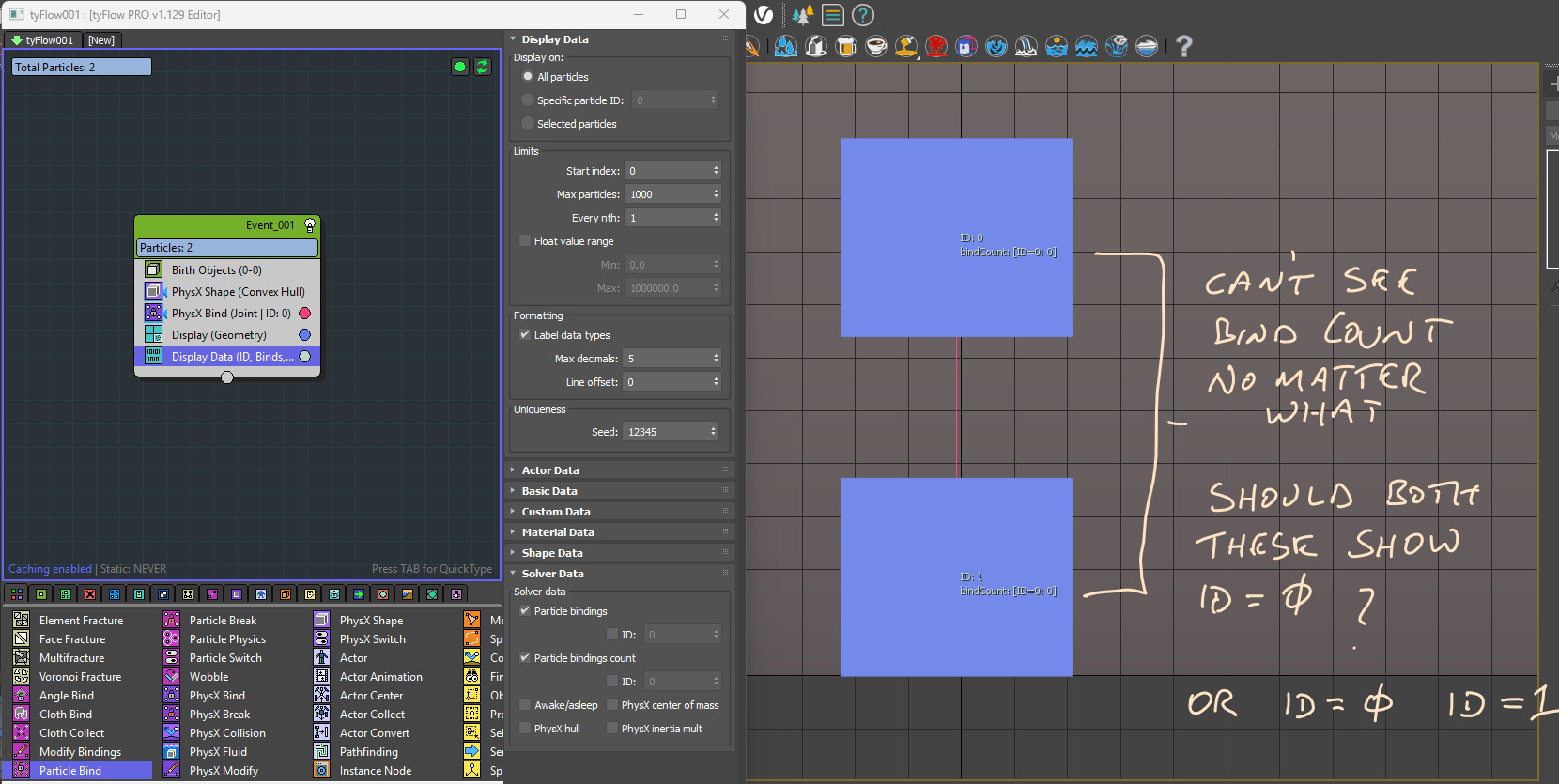

Is this a bug or am I doing it wrong? - Bind Count - rjanders0003 - 07-31-2025 G'Day Tyson No matter what I do, I can't get display data to show a bind count value other than 0 - I have tied every combination of display data settings I can think of. Am I doing it wrong or is there a bug, see attached screen. Rob RE: Is this a bug or am I doing it wrong? - Bind Count - tyFlow - 07-31-2025 PhysX bind aren't included in that total - only regular particle binds, cloth binds, etc. RE: Is this a bug or am I doing it wrong? - Bind Count - rjanders0003 - 07-31-2025 (07-31-2025, 04:59 PM)tyFlow Wrote: PhysX bind aren't included in that total - only regular particle binds, cloth binds, etc. Ok Thanks Is there no value to be able to do it for PhysX Binds ? - Sometimes its nice to understand whats happening behind the scenes Thanks Rob RE: Is this a bug or am I doing it wrong? - Bind Count - tyFlow - 08-01-2025 I can add it in. RE: Is this a bug or am I doing it wrong? - Bind Count - rjanders0003 - 08-01-2025 (08-01-2025, 12:09 PM)tyFlow Wrote: I can add it in. I just saw the new release I love you ![]() Rob |
