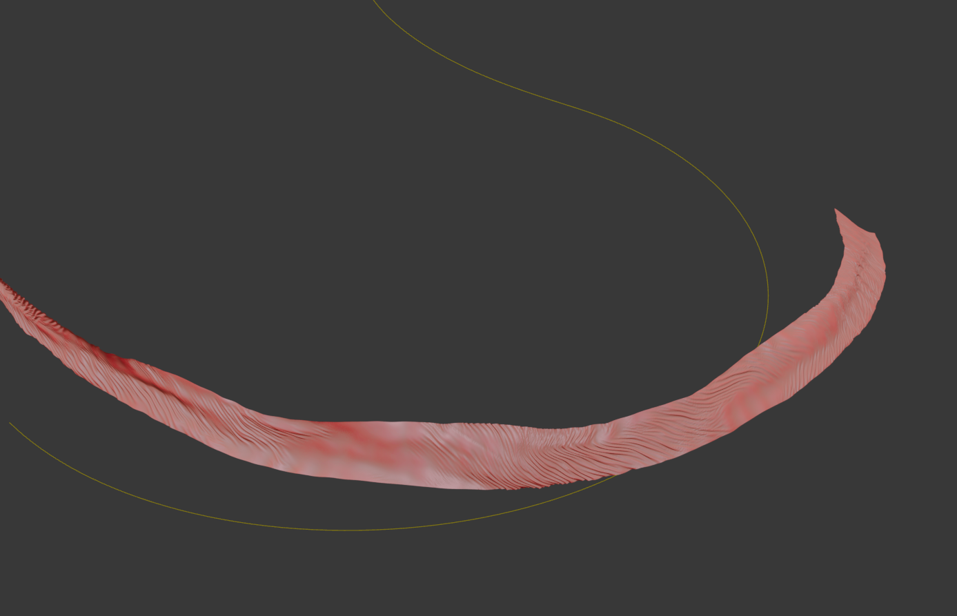

Hey guys!
Any idea of how to achieve something similar to this C4D tut? https://youtu.be/n3fJLi4Jaao
It is need to be a cloth ribbon, whirling through the scene along path.

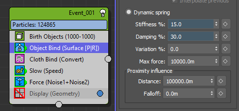

I'm using setup from this tut https://youtu.be/I64LcSPC5HA but for now it is far from the desireable resultĀ Undecided
RE: Cloth on path - tyFlow - 08-21-2025
Why are you using Object Bind? Use Path Follow in combination with a lot of damping (Slow).
