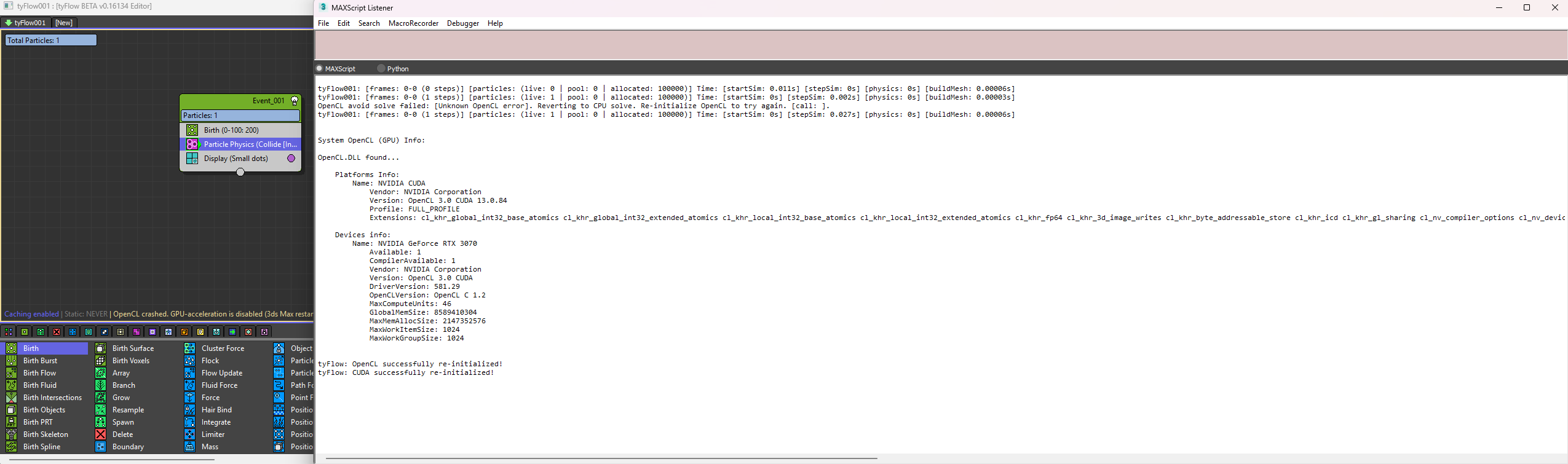

Hi, i am new to tyflow so i have problem that i didn't understand. so i tried the BETA 0.16135 and it awesome but after trying something. It has problem to export cache deformed meshes, after looking the solution i found it is well known bug of that version,and recomend to upgrade or downgrade to older version. So, i tried to dowload BETA 0.16134 and everytime i put particle physics i shows OpenCL Crashes..... i already tried so many solution that i found but it still didn't work,
1. Update/reintsall driver (didn't work)
2. remove opencl in max root  (didn't work) even i tried to copy system32 opencl to maxroot and it still didn't work
3. download the latest cuda in tyflow website and copy it to same plugin folder as tyflow.dlo (didn't work)
4. install the same cuda's version  (didn't work)
4. copy dll files into max root (didn't work)
i forgot to mention i tried to reinstall BETA 0.16135 and it works fine like nothing happen but for other previous versions (BETA 0.16132-4) it always errors. some of it didn't occur when first open after install but when i open project that i have work with BETA 0.16135, the error appears again and after that it always appear when i add particle physics even in new project like in the pics.
is anyone have other solution?
