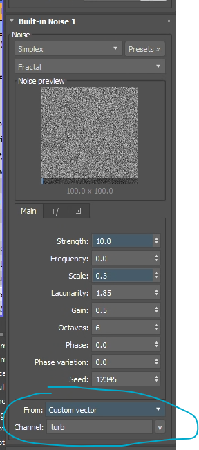

On the force turbulence rollout, there is an amazing option to provide a custom vector. I use this when needing to offset turbulence by not just pos but also pos+sInx if the positions are all stacked. (Thank you for the custom vector option btw super useful).

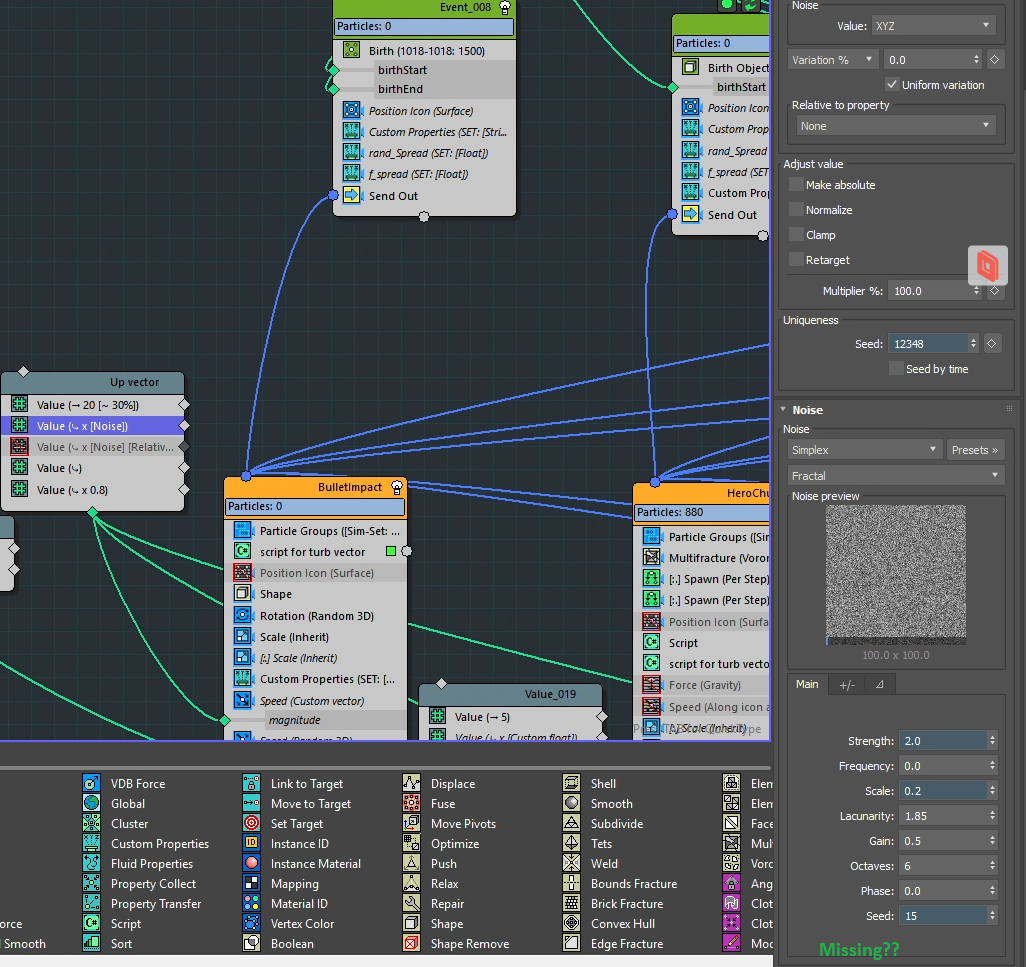

This option appears to be missing from the noise rollout on value operators. Could we add that in? Or, I'm open to other ideas on how to apply any custom values outside of using script operator for things like this.
Edit: Attached is a workaround file that does technically work, but it's not ideal. You store rest position for what position was, apply noise to it with script operator, do custom properties float - based on noise on this turbed up pos - restore pos back from rest - then apply force for one frame with magnitude set to custom float - the noise we made earlier. This works but it's certainly not ideal.
Thank you!
RE: From custom vector missing from Value operator on noise function - tyFlow - 08-26-2026
I could look into adding that, yes.
