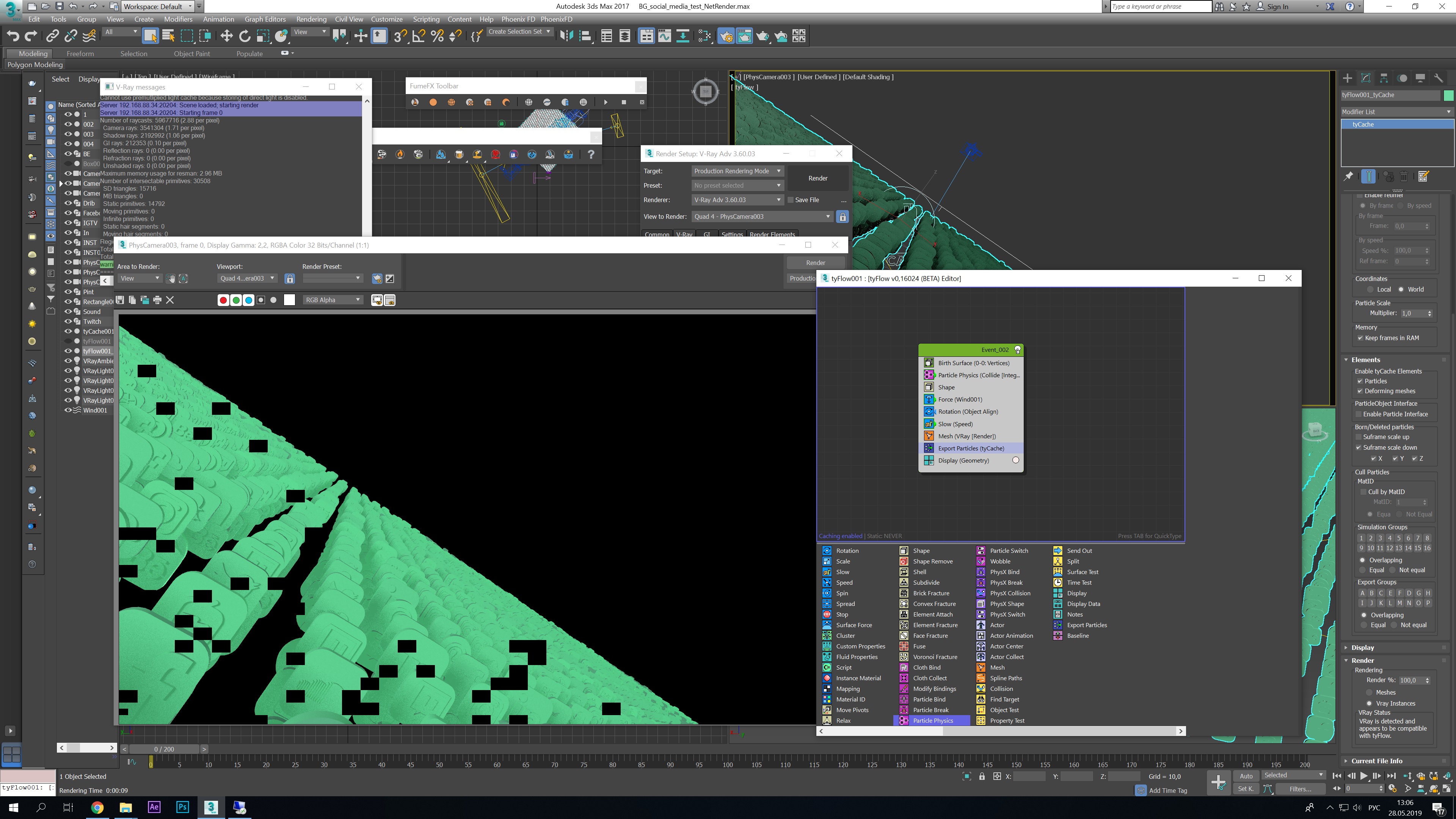

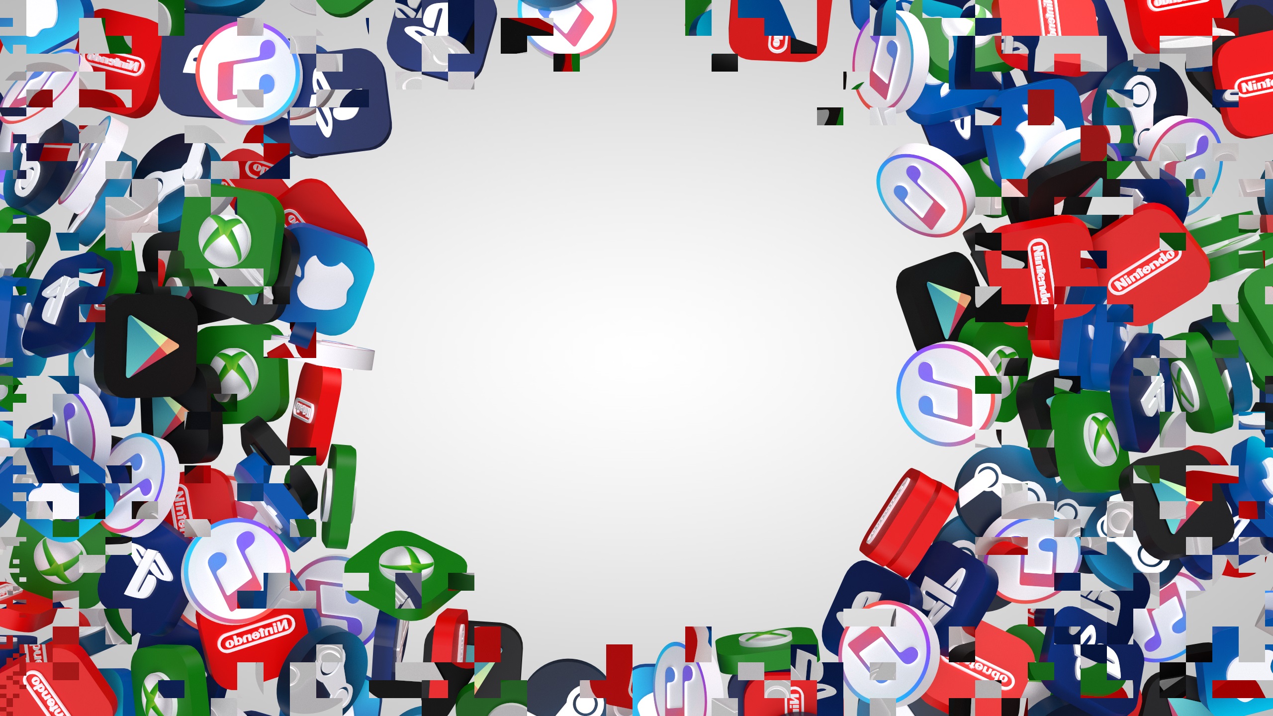

Distributed rendering - VRay - DimaFS - 05-27-2019 Hi, there was a problem with distributed rendering (vray). I attach the picture. Read the post - http://forum.tyflow.com/thread-301.html?highlight=distributed+rendering I did not help (( How to solve this problem? 3ds max and vray is the same everywhere, the project lies on the ball in the public domain. Each machine can safely open this project. RE: Distributed rendering - VRay - Borzacch - 05-27-2019 Try to bake with tyCache first RE: Distributed rendering - VRay - DimaFS - 05-27-2019 (05-27-2019, 03:56 PM)Borzacch Wrote: Try to bake with tyCache first tried, did not help
RE: Distributed rendering - VRay - tyFlow - 05-27-2019 That's pretty weird. Surely rendering a tyCache instead of a tyFlow directly should be an easy fix? Not sure your flow setup but if you're using Particle Physics make sure you read about strict determinism in the docs. RE: Distributed rendering - VRay - DimaFS - 05-28-2019 (05-27-2019, 10:58 PM)tyFlow Wrote: That's pretty weird. Surely rendering a tyCache instead of a tyFlow directly should be an easy fix? Not sure your flow setup but if you're using Particle Physics make sure you read about strict determinism in the docs. Exported to tyCache, before it added Particle Physics and included strict determinism, the result is again bugs (( |
