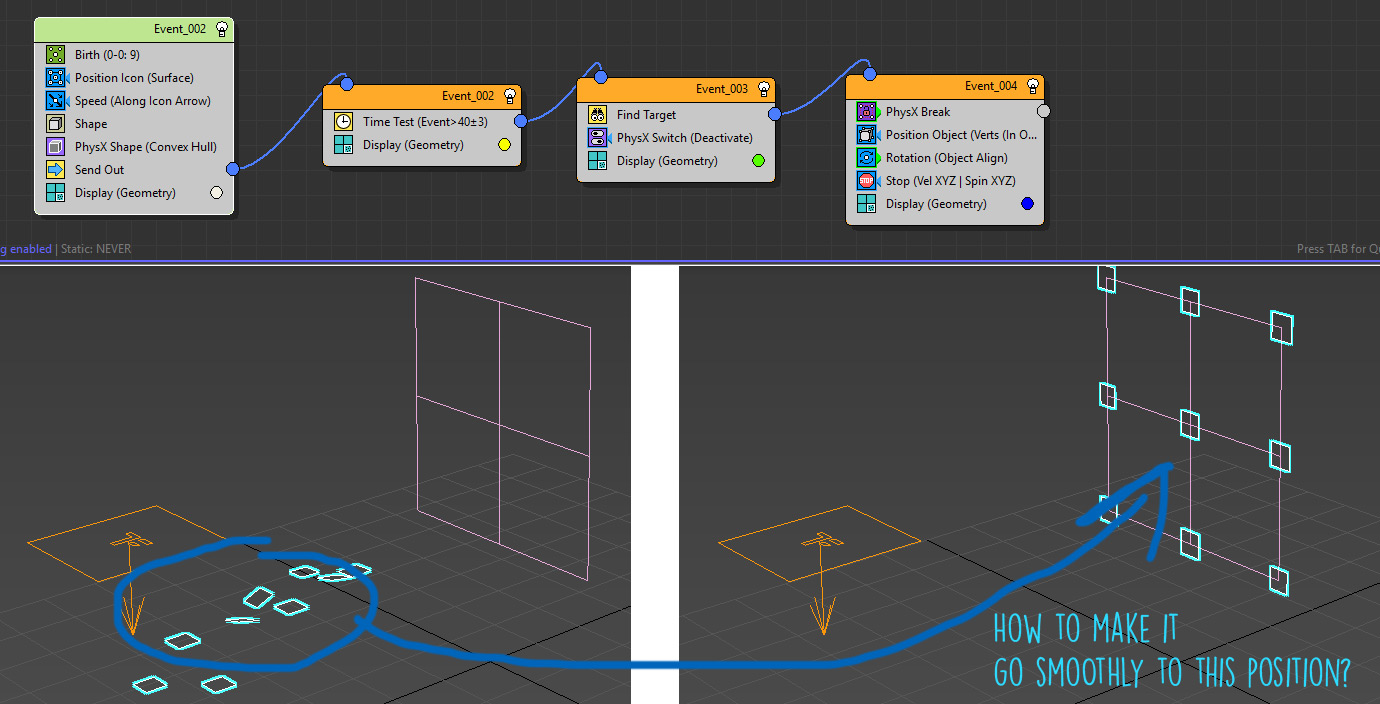

Hi everybody,
I'm only a beginner so... Wink
How can I make particles go smoothly to the "position"? I don't get it. I'm sending my file and the screenshot.
Thanks for this great plugin!
John
.max   Find_Target_test.max (Size: 676 KB / Downloads: 503)

But, I need it just like in the original scene.
First, I need particle "Boxes" to be in "PhysX" mode and then to go smoothly to the plane (perfectly aligned). I need this kind of tyflow structure for some more complicated animation.
Thanks again! Smile

I don't know if this is possible or not. Please see the attachments. I tried with custom properties but it's not working.
Is this a BUG or I don't know how to use it, but it should be a very simple task:
1. boxes are in perfect alignment (3x3)
2. boxes falls down (PhysX)
3. boxes are back in perfect alignment (start position)
Please anyone, if you know how can this be done, please help me...
Thank you Smile

RE: How to "Find Target" go smoothly to the position? - d4rk3lf - 06-02-2019
I just did it.
Here's the video:
https://youtu.be/QoZMt5Ei0Pc
In the attachment are files for max 2017 and 2018.
Notice the changes I made in the "custom properties" (the last one, in the last event), and I changed timing to "continuous", and interpolation to 0,1 (so it's smooth).
Maybe that was "bugging" you.

But... I have to be honest with you. As I said, I need this for much complex scene. This boxes are going to be 100s small screens that are going to create a grid of display, so it just has to be perfectly aligned. You can see that your boxes are pretty close but it's not perfectly. I already reported this as a bug and tyFlow assumes that it could be a bug. It's probably the PhysX.
So, I just continued working without PhysX, and it works perfectly.
Thank you so much for helping me!  Smile
Oh... I see...
If you turn off "spin random" operator in my scene, they should be back in perfect position (I just tested it).
I gave it spin random, only so I make it visually more interesting.
If you want spin to be there, then you can try saving the rotation parameter in custom properties, and load them back.
As for the Physx... maybe it's bug... bot notice this.
Physics by default have gravity that constantly pulls particle down, and you can't expect to work perfectly, because you need to add a force that will fight will gravity all the time.
I just animated gravity in Physics (select tyflow icon, and go to modify panel to find it) so it's zero after the boxes fall down - and it's working Smile
