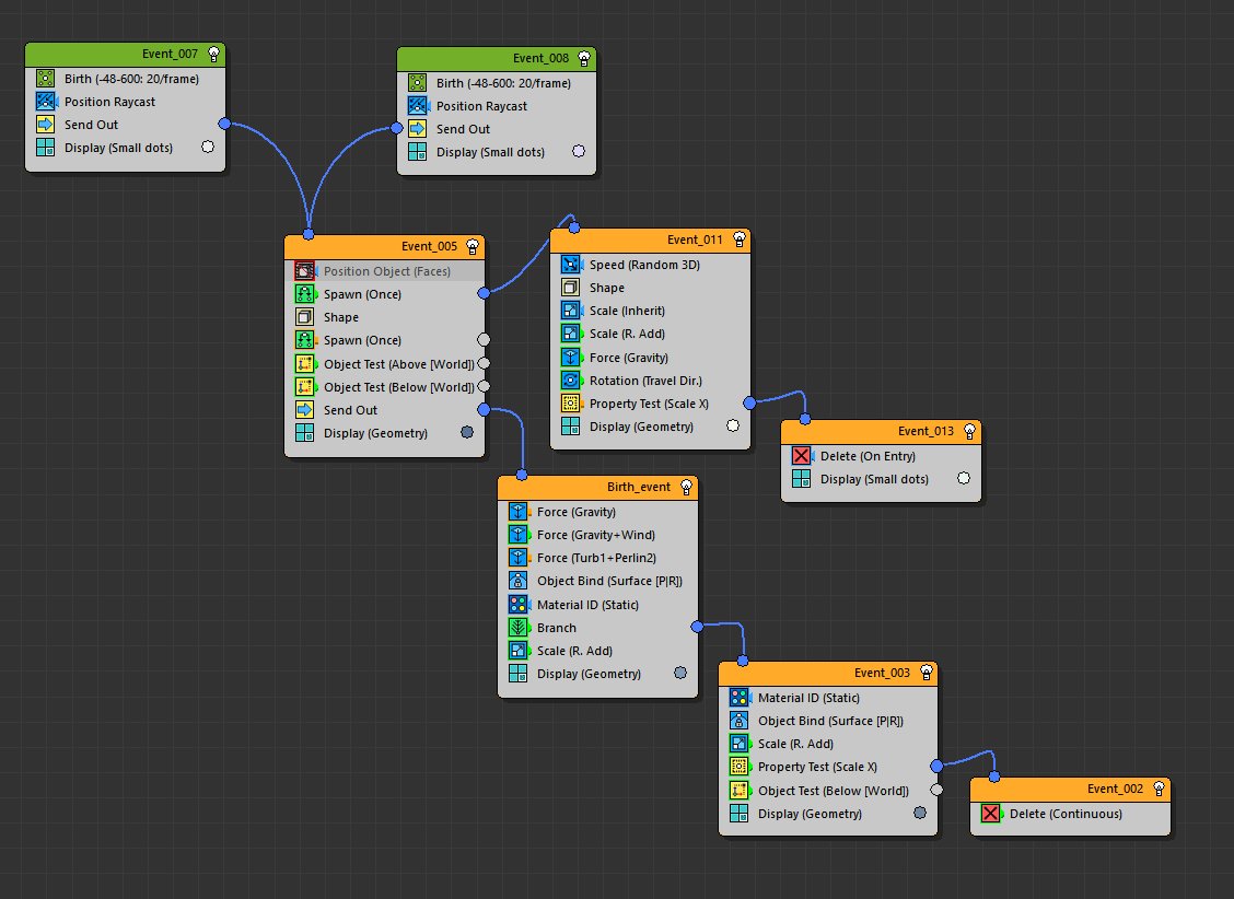

I have a flow that was created in beta 16030 and now has undesired results in 16034.  I've been trying to get the movement back to something similar to before the update, but not having much luck.  The particles movement via Object Bind operator seems to override my gravity forces much more dramatically than before, preventing the desired overall downward movement and flow I was getting previously.  Here's a link to previews using each build, as well as a screenshot of my flow.

RE: Dramatic Behavior Change - Build 30 vs 34 - tyFlow - 07-01-2019
The Object Bind operator code hasn't been changed between those version, but many of the other operators' core code was modified to include the addition of particle filters. Perhaps something is wonky in a different operator. Please upload the scene file or send to [email protected] so I can take a look.

(07-01-2019, 02:11 PM)tyFlow Wrote: The Object Bind operator code hasn't been changed between those version, but many of the other operators' core code was modified to include the addition of particle filters. Perhaps something is wonky in a different operator. Please upload the scene file or send to [email protected] so I can take a look.
Scene file sent via email.  Thanks Tyson!
