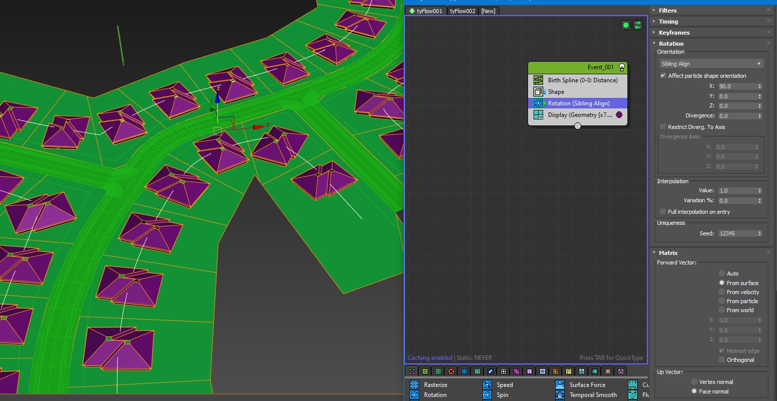

RE: Have particle orientation align to spline - aaron@vector6.com.au - 09-07-2021
I have also attempted this with a less than desirable result. Rotation Sibling Align proving to be the best solution. Ideally, I would like to see Align by spline vector (Follow) with Z Up Axis.
I would also like to see position offsets based on their location with random variations adjustable for each axis.
