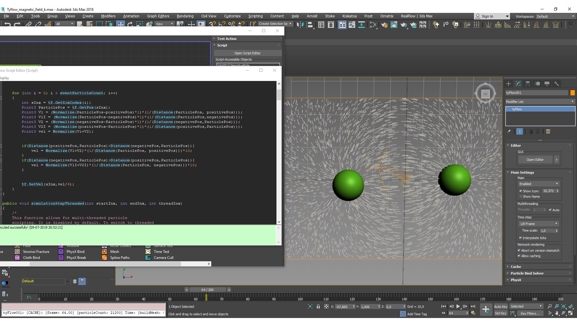

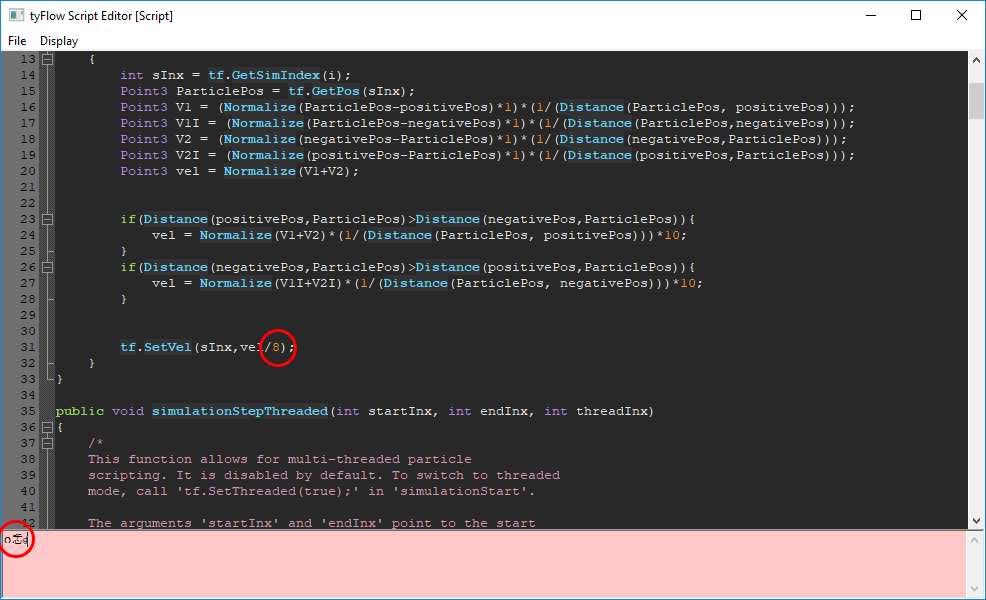

Bug in script editor - Szezar - 07-09-2019 Hi Tyson, I created a magnetic field simulation in tyflow script editor and I found a strang thing. I would like slow down the velocity so I divided the value. With value 8 it has a bug. I attached the max file and screenshots. Thanks for your fantastic work! ![]() RE: Bug in script editor - tyFlow - 07-11-2019 Very weird, I'll look into it when I get a chance...thanks for providing the scene file. RE: Bug in script editor - tyFlow - 07-11-2019 I loaded your file and was not able to reproduce the issue. Both values of 4 and 8 worked fine. However, your file was corrupted with the 3dsmax ALC virus. It can affect scripts and perhaps your max install is corrupted because of it, which may be affecting script evaluation in tyFlow. Please install 3dsmax security tools to clean the file and your max installation. I have also removed your attachment so others do not download it. https://apps.autodesk.com/3DSMAX/en/Detail/Index?id=7342616782204846316&appLang=en&os=Win64 Also please ensure you are using the latest version of tyFlow (v0.16037). RE: Bug in script editor - Szezar - 07-12-2019 (07-11-2019, 06:02 PM)tyFlow Wrote: I loaded your file and was not able to reproduce the issue. Both values of 4 and 8 worked fine.Oh. Thank you very much. This solved my viewport problem too, which worked strangely last week. It was wierd! ![]() Thanks again! ![]() |
