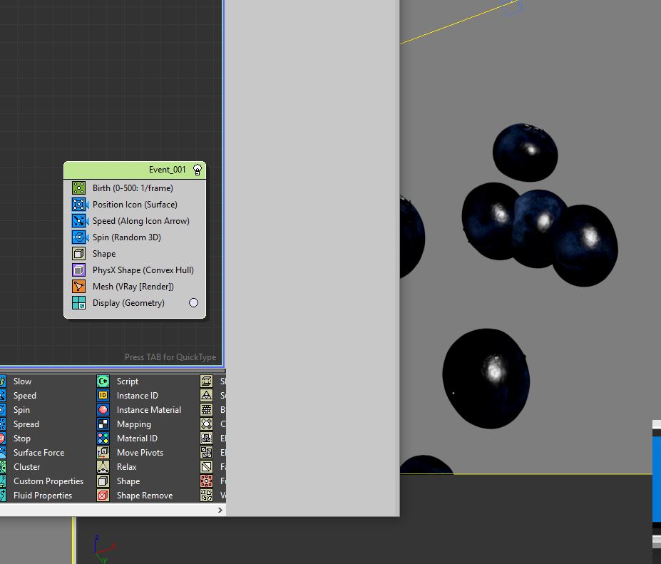

Collision Operator? - Streetwise - 08-02-2019 What operator do I need to add to the event in order to create collisions rather than an overlapping of particles? Thanks. RE: Collision Operator? - tyFlow - 08-02-2019 Check the Convex hull of your PhysX shape to ensure it's big enough to encapsulate the particles. If you're asking how to ensure they are separate at frame 0, and not simply during the sim later on, use a Particle Physics operator (with integration turned off, affect position on, and timing to entry) to separate born particles. Put it immediately after your Position Icon operator. |
