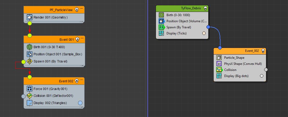

Travel Distance - pati - 08-06-2019 Hello. Now, when using Spawn by Travel Distance, the source is the particles. However, I want an option where the Position Object becomes the source of Travel Distance particles. Like a Pflow.. Thank you! RE: Travel Distance - tyFlow - 08-07-2019 I'm not sure what you mean....just use an Object Bind to bind your birth particles to the box and the spawn by travel will leave trails behind them as they move... |
