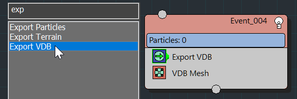

Hello,
when I got a nice VDB - is it possible to export this as mesh?
I have seen "export VDB", but this is seems not to have an export "as mesh" option.

Export VDB will export to the VDB format.
For straight mesh export, use an Export Particles operator and then in the additional geometry rollout make sure VDB meshes is enabled.
