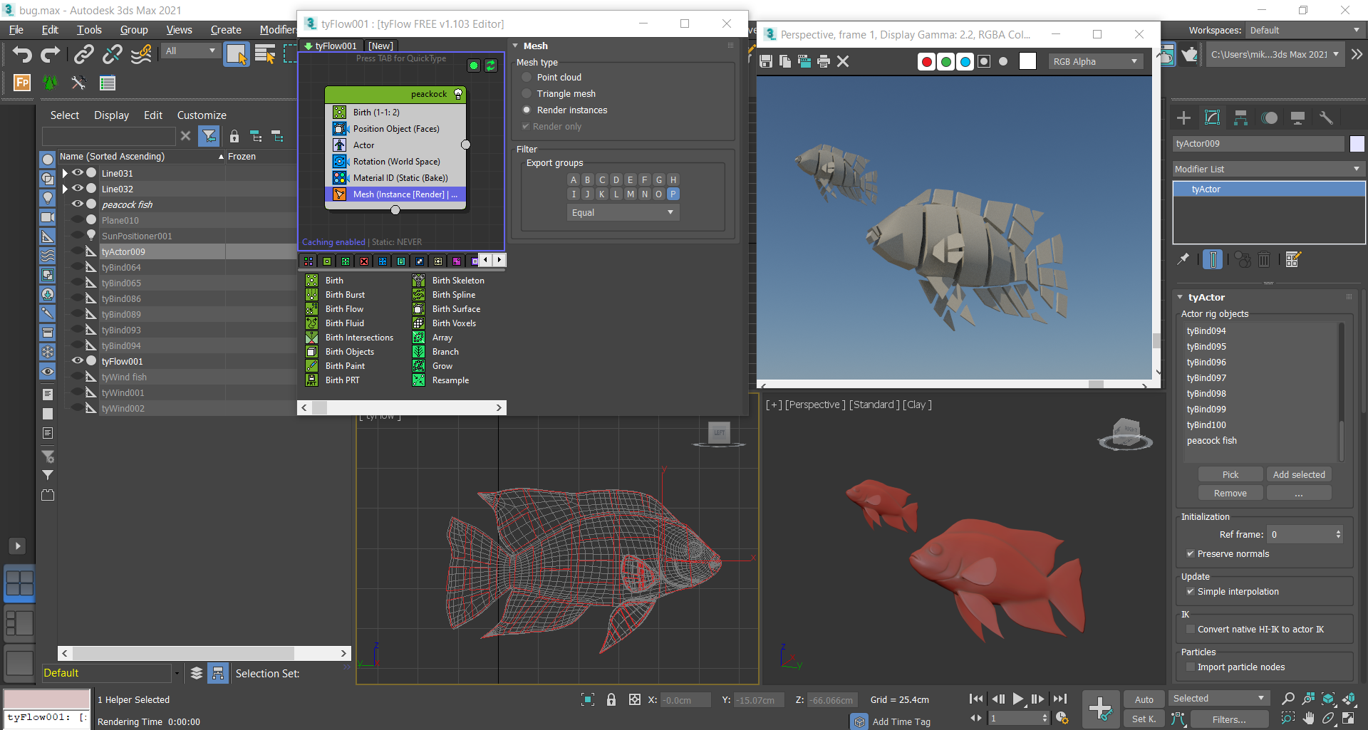

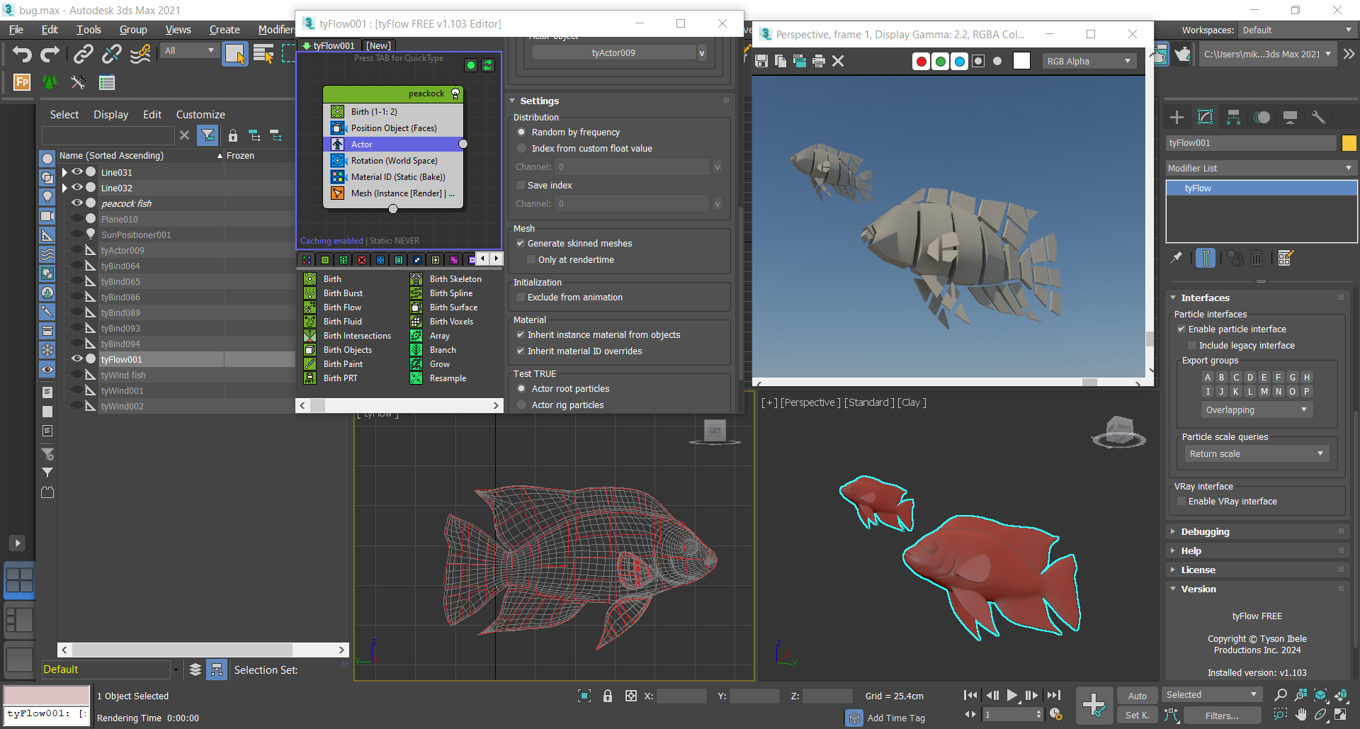

[Image: 3.png][Image: 2.png][Image: 1.png]
Please use the tyParticleObjectExt interface instead. I've attached it here.

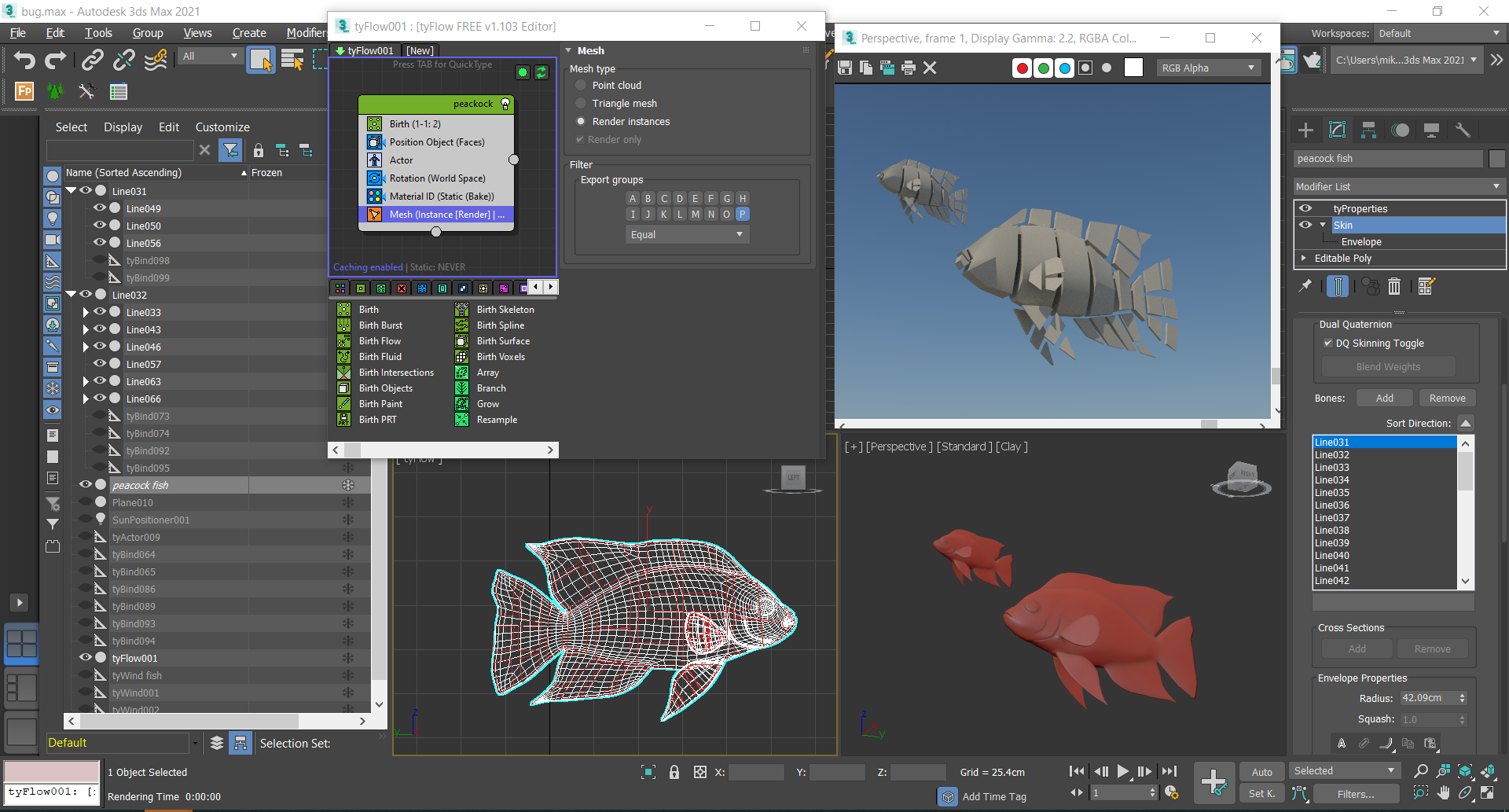

2. What should I change in the scene to render the skin, not the bones? I have tried everything without success. If "Enable particle interface" is set, then tyParticleInterface is available and returns bones, not skin.
If checkbox is off, then tyParticleInterface is not available and tyFlow returns (using GetRenderMesh) correct skinned single triangle mesh with all fishes at once that is not appropriate.

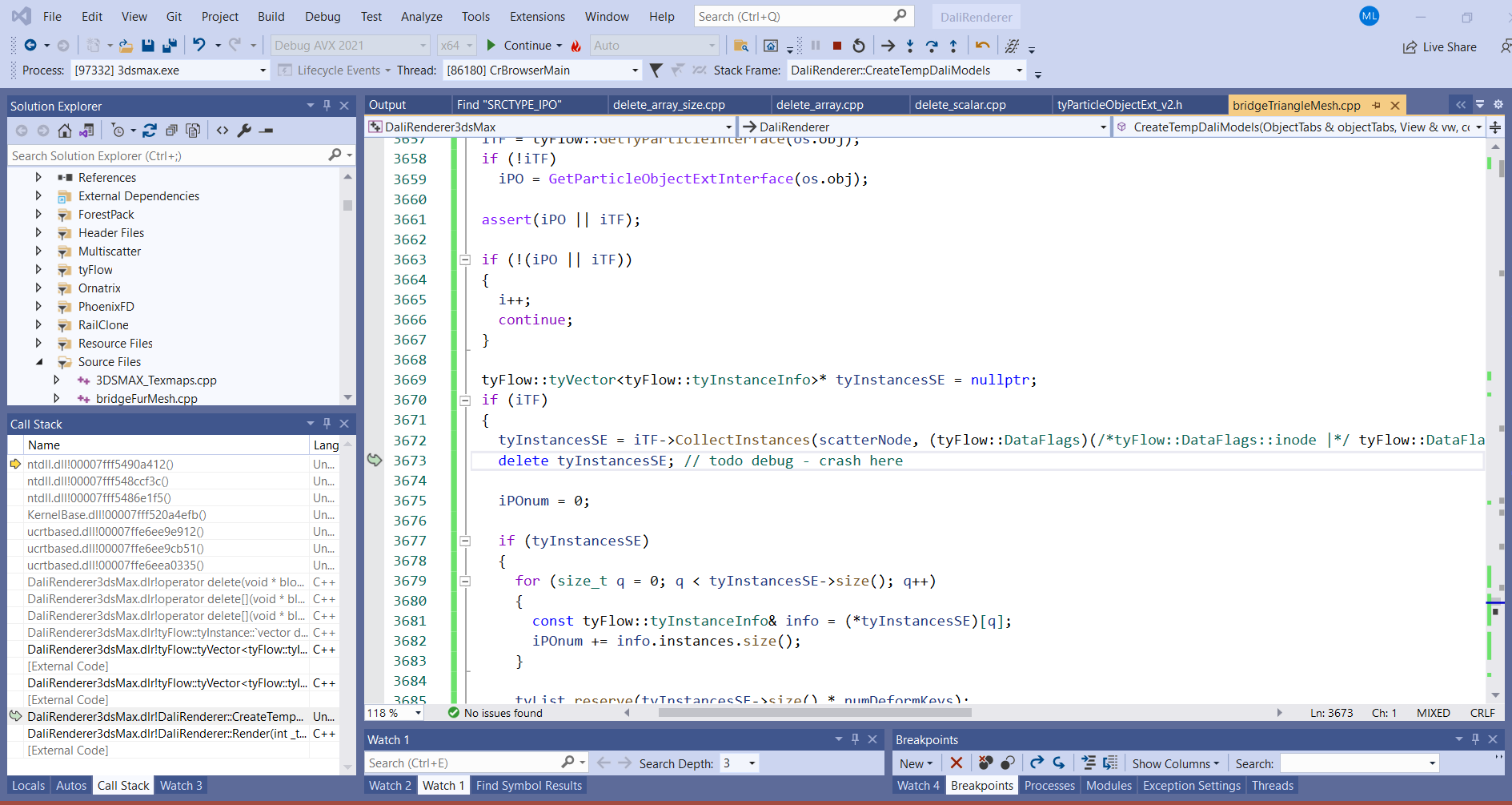

[Image: crash.png]
This is a test example - first line allocates instances, second line deletes them.

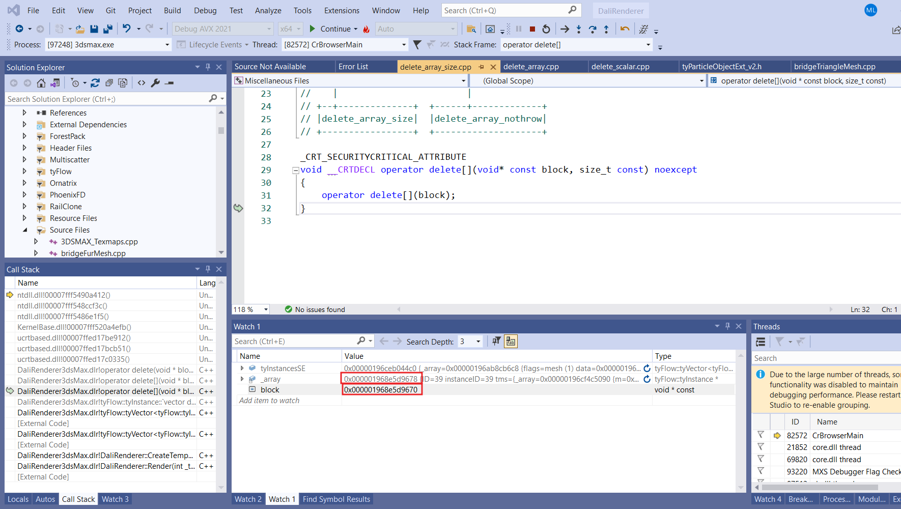

The reason is clear, I have seen this already in other projects. The memory block was allocated with one version of CRT, but is deallocating with different version.
See the picture. Starting from some version of tools, Microsoft VC adds 8 bytes for arrays, allocated with new[]. So pointer to array itself is shifted by 8 bytes comparing to memory block.
What is the version of VC, Windows SDK used for tyFlow ?
[Image: b1.png]
