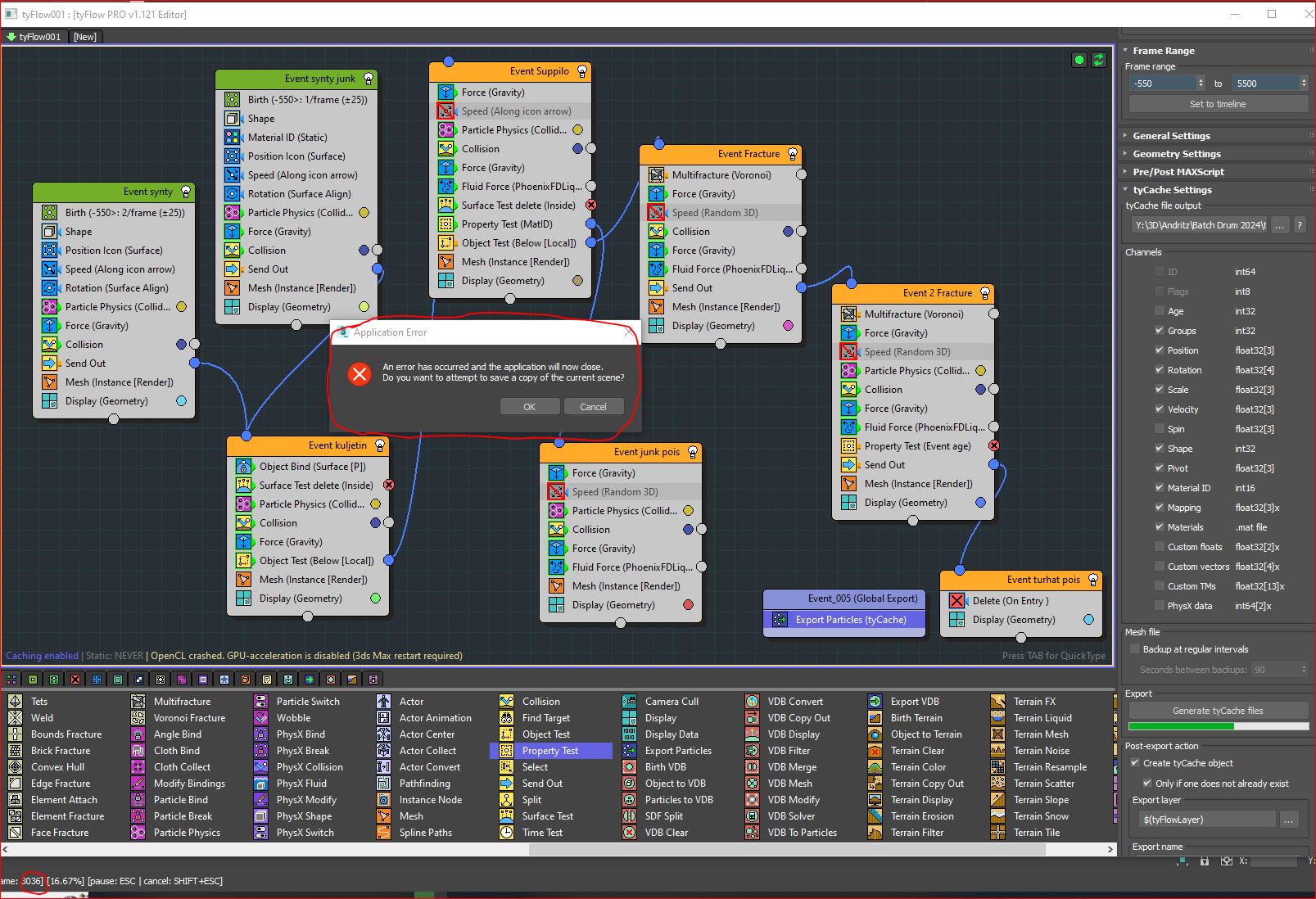

I wonder what's happening. I got this error during tyFlow simulation.
#34

So far this is the best result I can get. Any ideas, why Max keeps on crashing during the simulation?
#36
You are maybe running out of RAM memory.
Try grabbing TyFlow object, and in the modify panel, under the cache, turn of "enable playback cache", then try to export again.

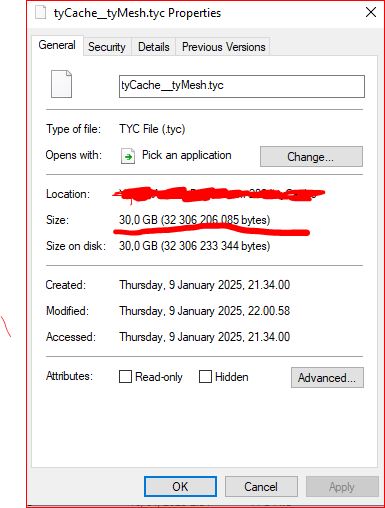

I just looked my cache file and it's already 40 GB. At the moment there should mostly dead particles, but it's still 80 MB/frame.

Also there's only tiny fraction of needed particles baked, but the cache shows about 80 GB. Also when trying to render, I got Bluescreen. Any idea what's going on here?

I still don't get it. I have two types of particles. Those that dissolve and those that don't the latter being junk. On this setup I have only those that dissolve. Now I want to add some particle shapes that don't dissolve and eventually are transferred to the junk trap. I'm looking a way to "flag" these particles in the shape operator. Nothing else makes sense to me. Then I need an operator that takes the flagged particles off from main flow before they end to fracture events.
Edit: I see there's a possibility add another shape operator. So in theory I might add the junk particles there, but there's still the "flag" issue.

I have placed object test below to be more like a timer. Passing this level starts delay timer. After certain time particles move to fracture event, but they are staying in the same area since they are in the dissolving process. Then I have another event they fracture even more and after another delay are deleted (dissolved into liquid). I do the liquid part with Chaos Phoenix while tyFlow particles are deleted after becoming small. The liquid is screened away so there will be left only intact junk particles in the volume - so in the end I have liquid at a liquid pool and junk particles in the junk trap. The liquid changes color during the process duo to dissolved particles.
In the beginning I have two kinds of particles in the same birth event: the ones that will be dissolved and vanished and the ones that will stay intact and travel to junk trap.

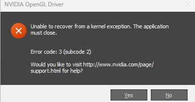

I noticed another thing. I can't open my render scene anymore. If I try to render the backburner task, that was perfectly working before, it causes bluescreen. It contains tyFlow cache so I can have the project to be rendered independently while I work with tyFlow make the particle systems better. I have the feeling, that it's caused by tyFlow Cache. Is it safe to delete that 30GB file?
What that file stands for?

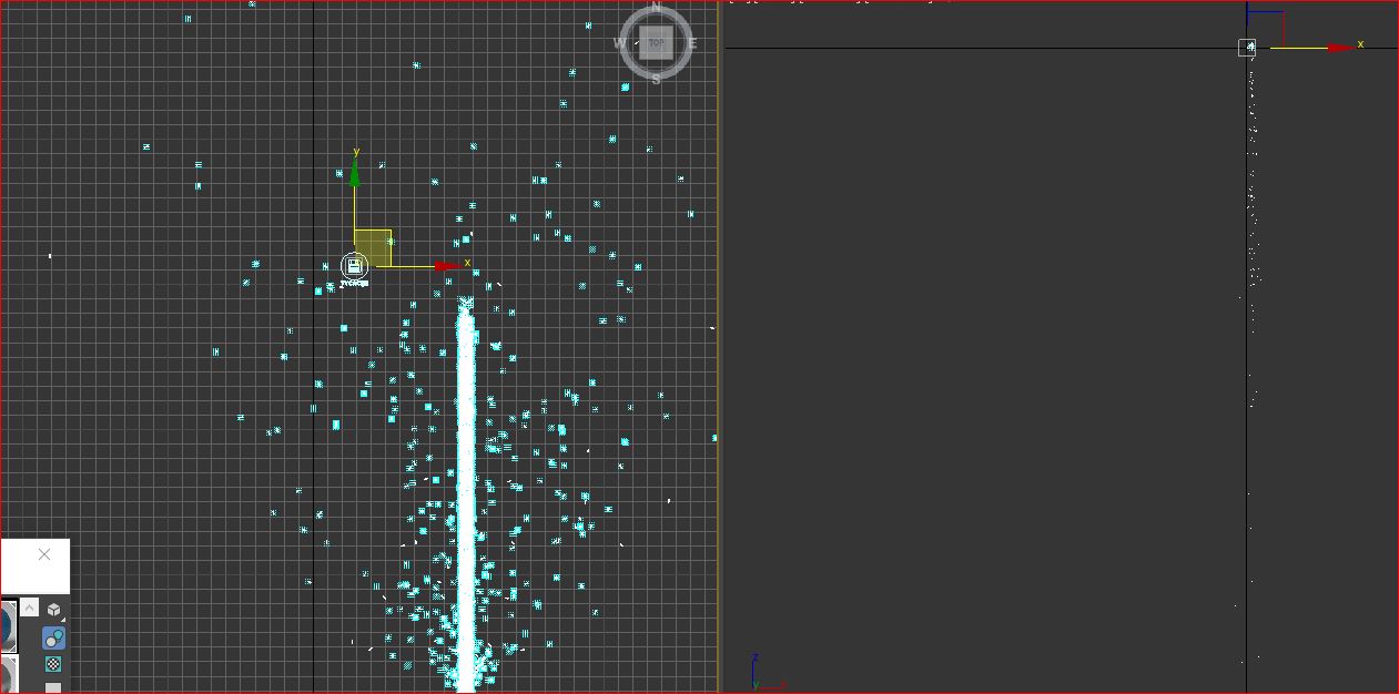

I decided to start this project all over again. The fracture operator has been causing problems all the time. I have simplified the system to two events and forgot the idea of dividing to flow inro two streams. I working now with two independent particle systems: one for particles to be dissolved and other without dissolving (the junk particles).
The fracture operator is a bit confusing. Somewhat ideal solution would be the one, where particles are split into two then again few times until they would be deleted by their size. Is this doable?
