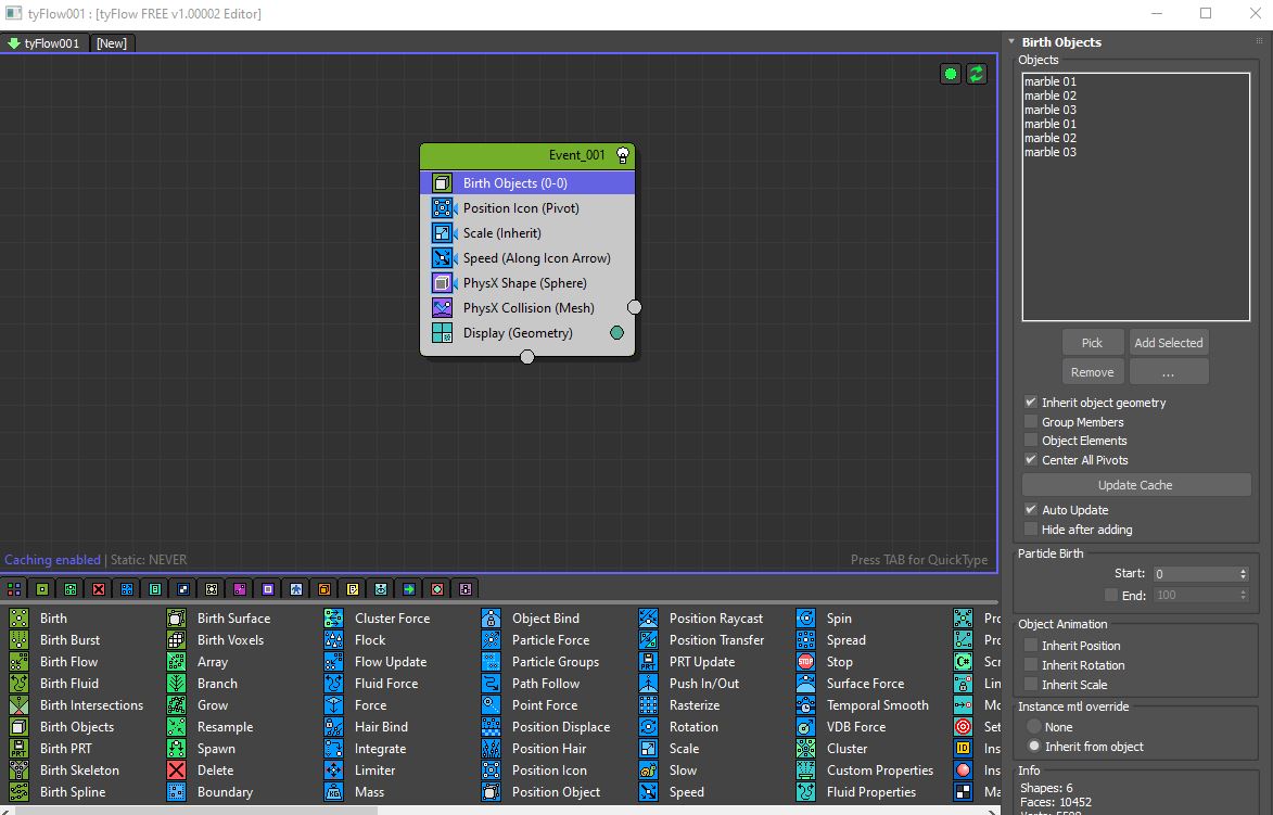

I'd simply like to take 3 separate marble objects (they are grouped objects because of the little squiggle in the center)...
And have them stream randomly (between the 3 objects) out of the tube being birthed inline from the position icon (very much like if you simply took the 'shape' operator and had 3d spheres flow out)...
However, as you can see from the image, that's not happening with the way I have it set up.
Currently, all marbles appear at the same time and the system lines them up upon birth. Also, the materials for marble 02 and 03 are being ignored and only the marble 01 texture is being assigned.
Here's my current setup. I get why it's NOT working but can't seem to figure out a solution...
Thanks so much for looking at this!

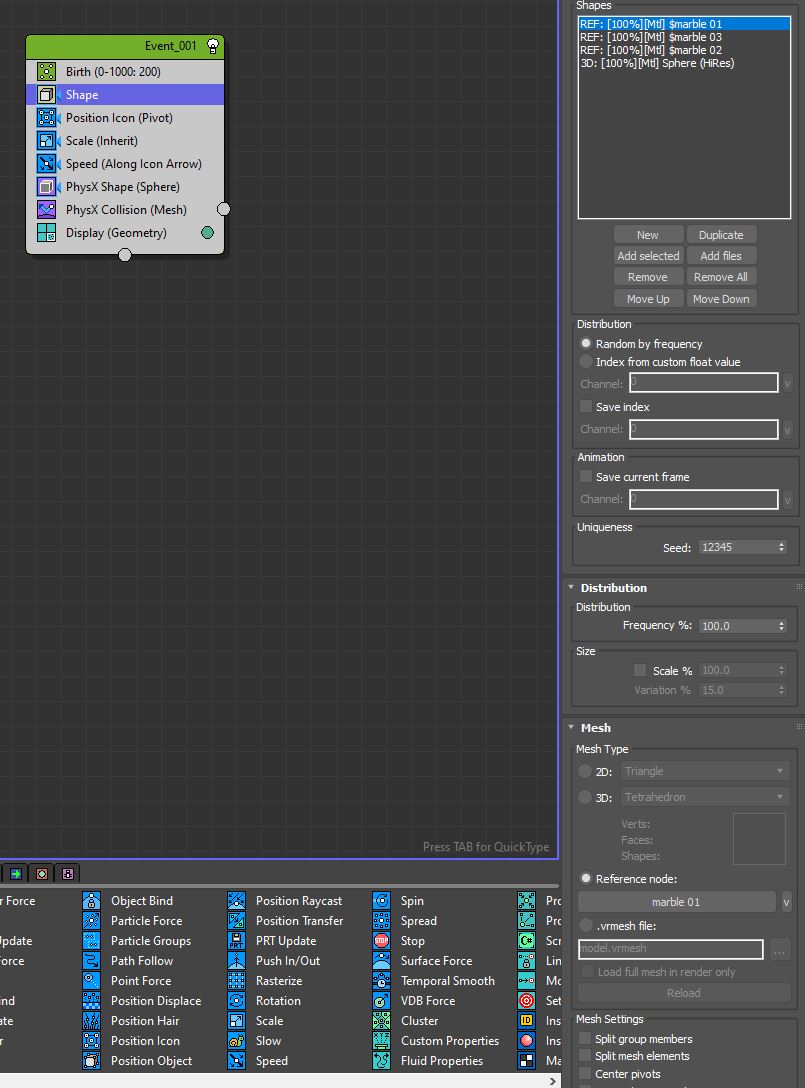

As you can see in the screenshot, It was all about utilizing the "reference node" option under "mesh" in the "shape" operator...
This is what I originally tried before I sent up the flair and I THOUGHT it wasn't working but I was wrong.  While using 3DSMax with the Active Shade window open I'm finding the software behaves very janky and really sucks up bandwidth. This causes elements in the program to really lag or malfunction.  I intuitively figured the way to get a custom shape into the tyflow system would be by using the birth and then shape operators. But when I would mouse over the box under the "reference node" it wouldn't react. And when I clicked on the box it wouldn't react. So, I assumed it was locked out because I hadn't chosen the proper birth approach.

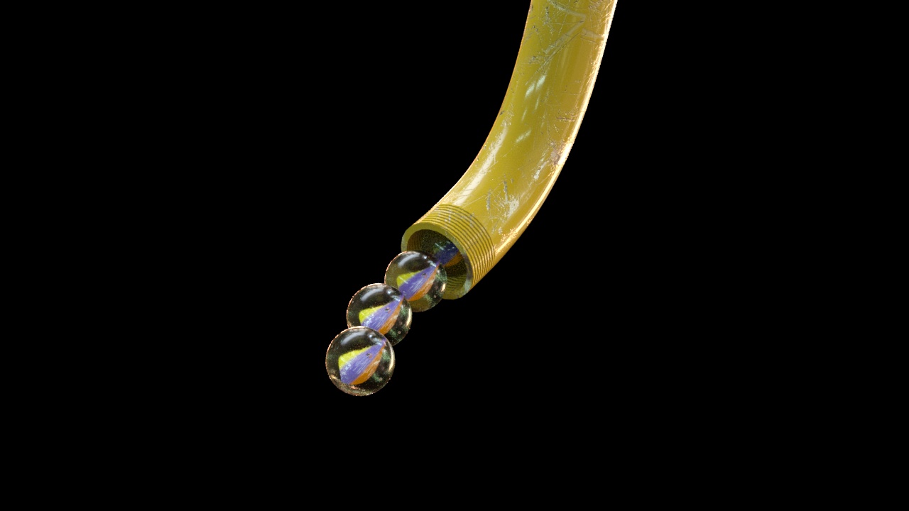

As it turns out, it was solely because I had Active Shade open and that was truncating Tyflow's functionality. With Active Shade off, I moused over the box and it reacted to my mouse over and my click and sticking in my marble objects was a breeze. As you can see from the test render below, I now have control over a deluge of custom objects (and a template sphere shape).
