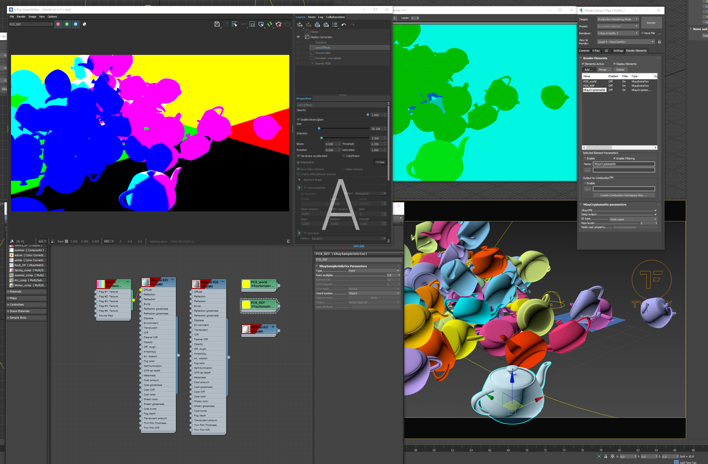

I want to obtain Position Reference information.
Let's say I have a scene in TYFlow where a large number of objects are falling.
I could get the WorldPotion in RenderElement, but could not get the Position Reference and Cryptomatte correctly.
The teapot in the foreground of the screenshot is not a TY, but a standalone OBJ.
This was obtained correctly.
Is there any way to get Cryptomatte and Position Reference correctly in TY?
I would like to retrieve the information at the following link.
https://erwanleroy.com/create-position-r...-for-maya/
Sends a scene with render elements set.
.max   Fition_test_sc.max (Size: 1.06 MB / Downloads: 200)
