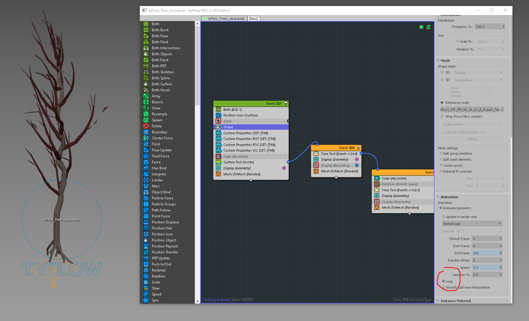

It's a tree made in growfx (wind animation)
I add it now as a shape, checked animation. it now plays the animation as it should. but it does not loop.
The tree animation is 250 frames, but the tyflow is 600. I thought the loop checkbox in the animation parameters would loop but it just stops after frame 250. am I doing something wrong ?
