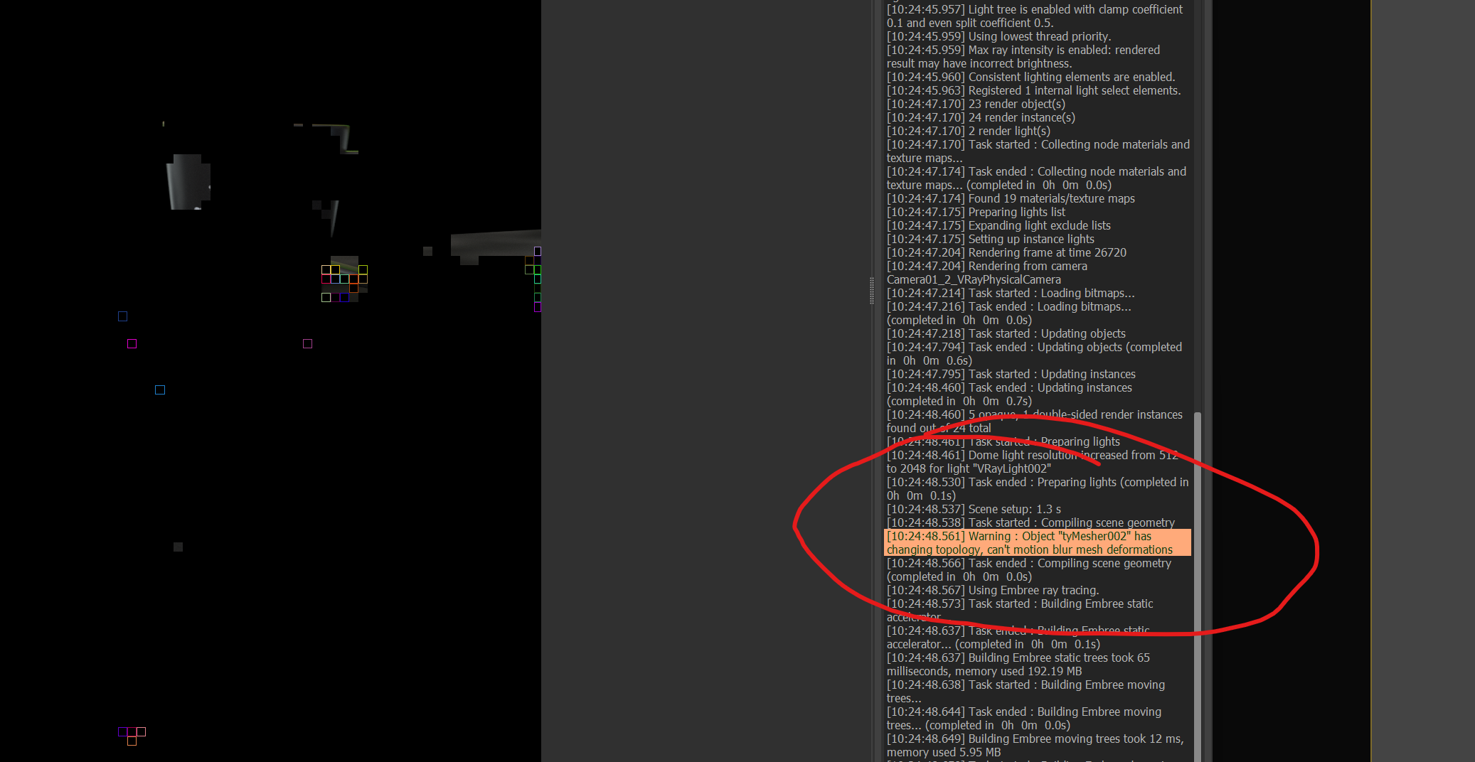

Thank you for your reply and the useful info, let me show you a video screenrec of what's happening I tried to trigger the error by myself now
check it is uploaded on this link: https://youtu.be/EmMHGrko6vM
also this is a log error in vray check it attached, no motion blur! I really need motion blur to have it perfectly why is that? or motion blur does not work with gaussian?
