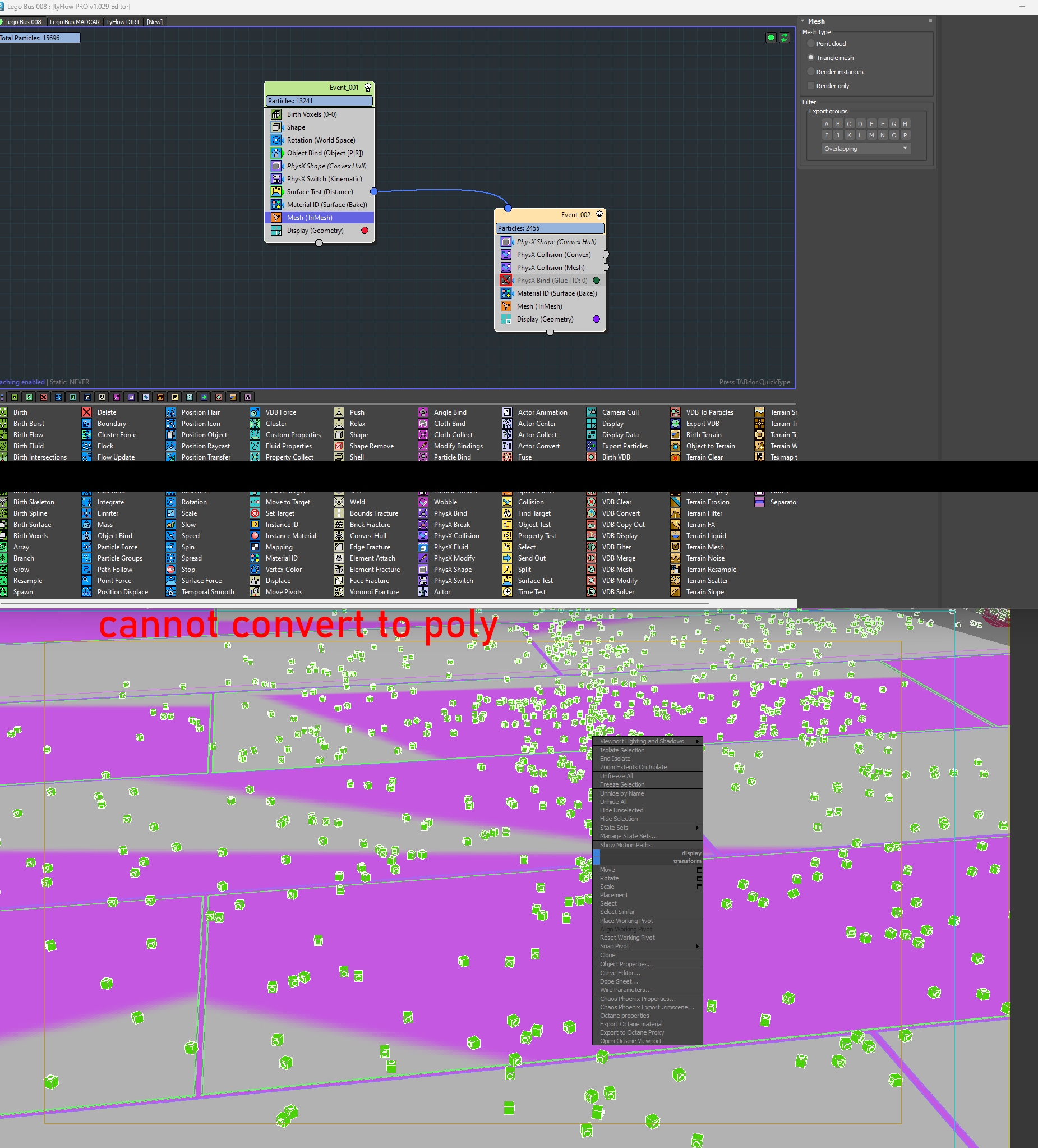

(08-20-2019, 05:02 AM)apratim_appie Wrote: put a mesh operator in the flow and tick off the Render Only then go to the frame on which you want to stabilize them and then right click convert to editable poly.
but this will kill all your animation in that flow. Make sure you put that ground object in another flow.
Hi  I dont see convert to poly
