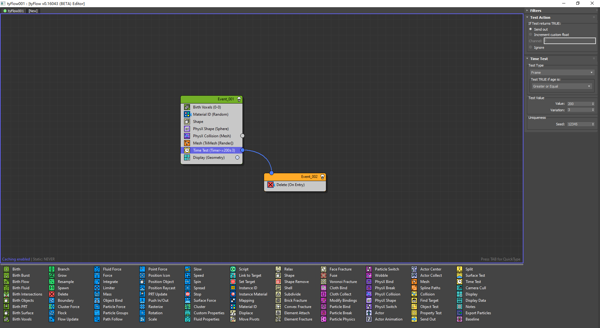

I added  "Time Test" and  "Delete" operators , set the "test value" to 200 frame, the paticles disappear immediately at 200 frame, I want to let the particles disappear gradually, how to do it?
this is my operator settings:

Increase variation parameter.
Right now, it's 3, and the value is 200.
if you increase it from 3 to... let's say... 25... they will start disappearing from 175 to 225 (25+ and -25 from the actual value of 200).
That's how variation works.

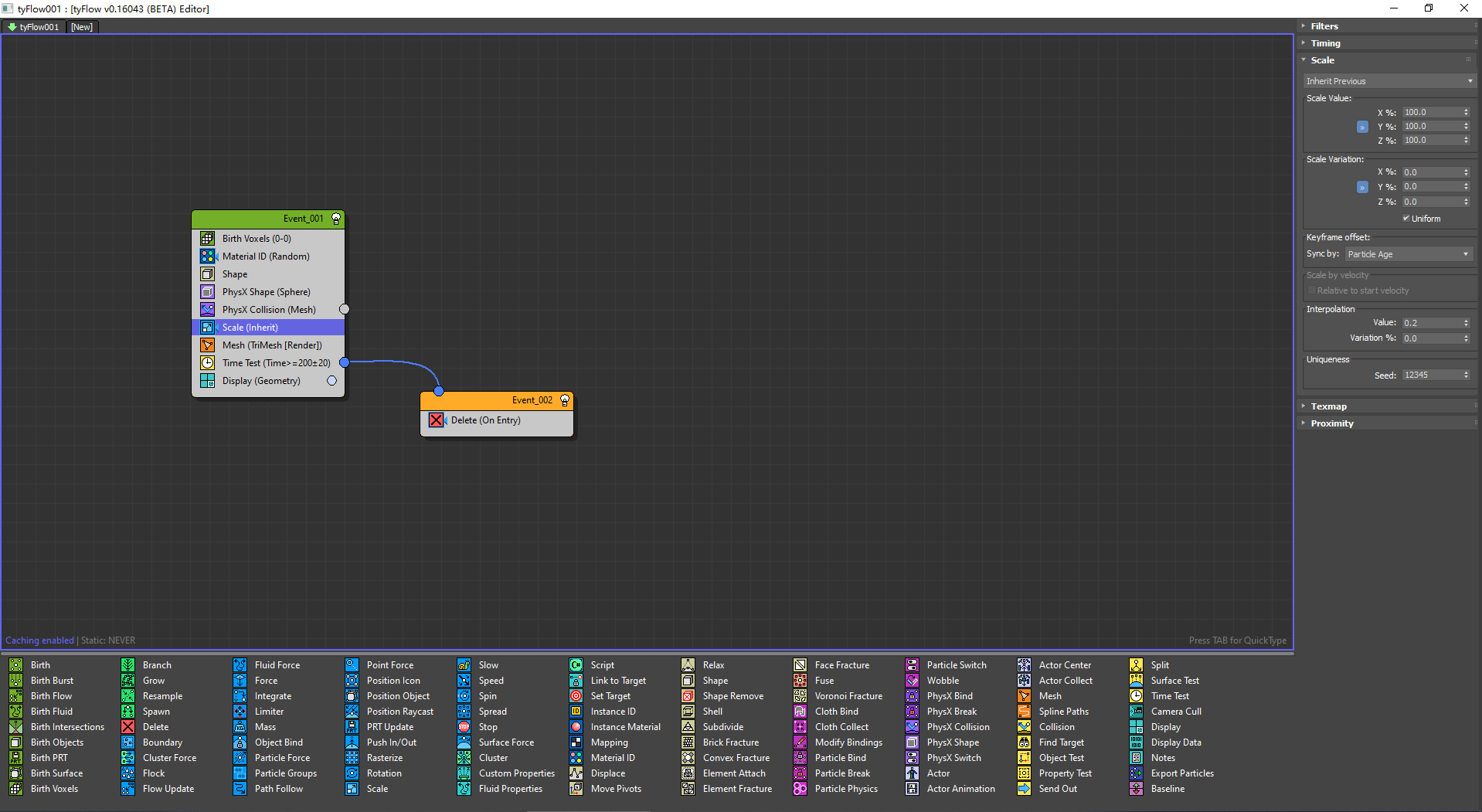

If you want to disappear like the second sample (being smaller and smaller), you need a scale operator, and you need to animate scale and set it to particle age.
(08-28-2019, 10:58 AM)d4rk3lf Wrote: If you want to disappear like the second sample (being smaller and smaller), you need a scale operator, and you need to animate scale and set it to particle age.
I added a scale operator, could you please show me how to set the parameters?

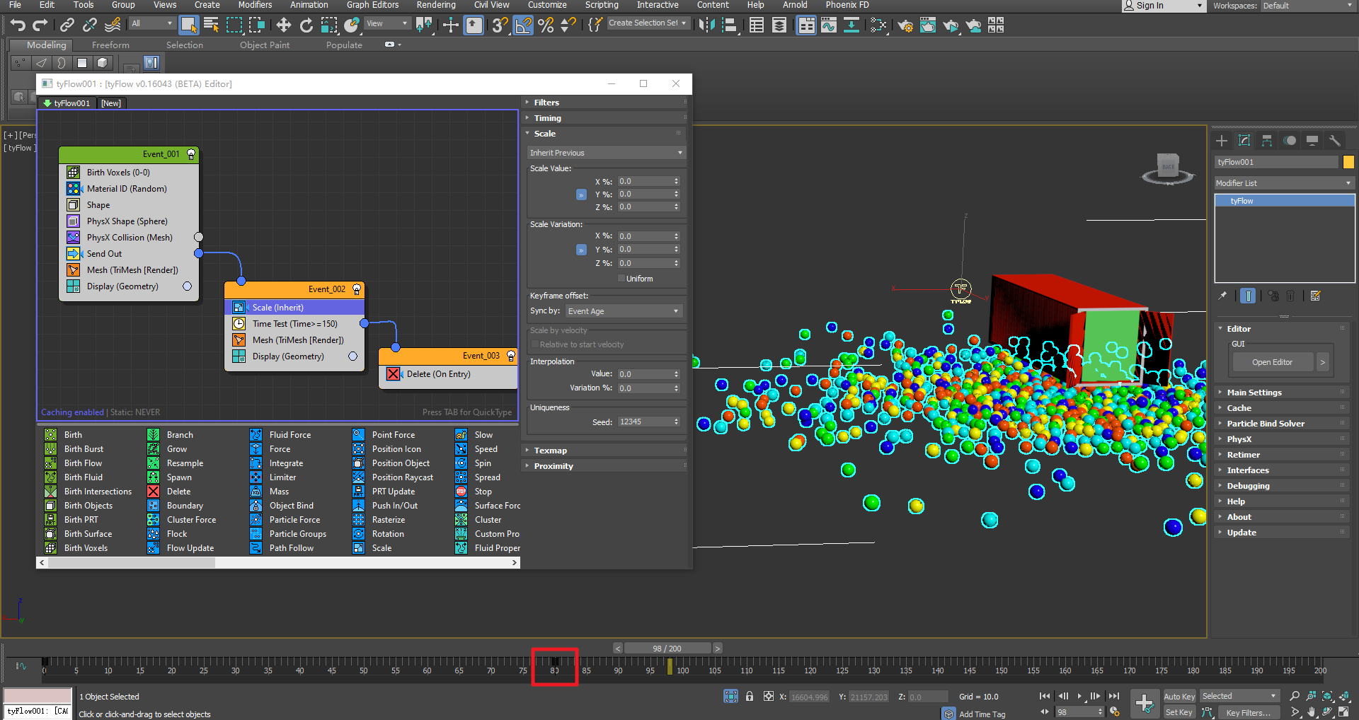

I'm muddled, I uploaded my file, could you please help me adjust it?
.zip   box-particles-demo-02.zip (Size: 162.59 KB / Downloads: 401)
Save it for 2018, because I am using that version.
Nevermind.
I'll be busy later, so I did you a simple scene of balls gradually scaling.
What I forgot to mention in my previous explanation is that you need to set a scale operator timing parameter to continuous.
.rar   balls scale.rar (Size: 34.58 KB / Downloads: 498)
