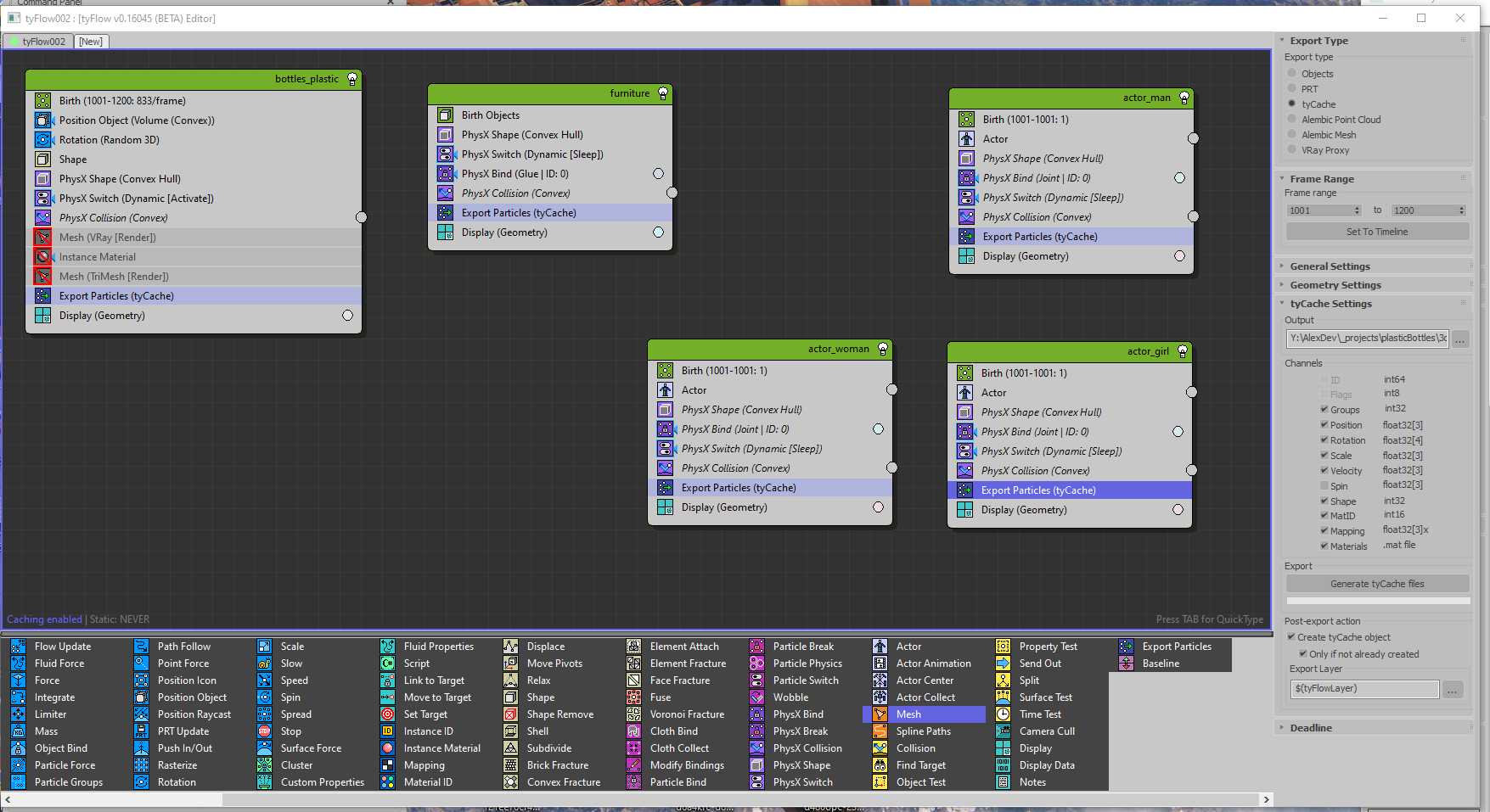

This is my flow if that helps! Totally expect it's something I've missed etc -
Not much to distill from just a screenshot in this case, if you can send the file to support@tyflow.com I can take a closer look.
