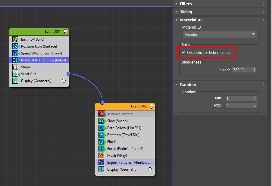

Hey everyone, i have setup tyflow to give random material ID 1-4, which renders fine using tyflow.
however, i may need to render these on the render farm, so trying to export it as alembic mesh and render it.
when exporting to alembic mesh, mesh comes through fine, but seems to loose the material ID, so it comes in as a single material ID mesh.
i have setup tyflow material ID to random and "bake with particle mesh" turned on.
is this limitation of alembic file format? or am i missing something here?
thanks!

it creates the alembic mesh file.  however, i can't get it to save out material ID, which i am generating randomly using [Material ID] event in tyFlow (as per previous post screen capture.

Max's own importer/exporter uses outdated methods in the Alembic SDK to do things like matID save/load. Also the way it processes matIDs is broken to begin with. So while its importer "works" with its exporter, it isn't compatible with "properly" exported abc files in some cases. This is probably what you're running into. VRay's Proxy object can import .abc files and does a good job of it. Try to default to that as your importer if possible.
The reason why export isn't working from max's exporter is because you do not have Mesh operators in your flow with "render only" turned off.

So I found a way to make this work. As Tyson suggests add a mesh operator to the end of all your flows and uncheck render only. Then add an edit poly modifier to the tyflow icon. Then export selected as alembic from the max file menu. Make sure to check Material ID in the export dialog. This seems to work for me. When I reimport the alembic the material ids are present. Hope this helps.
