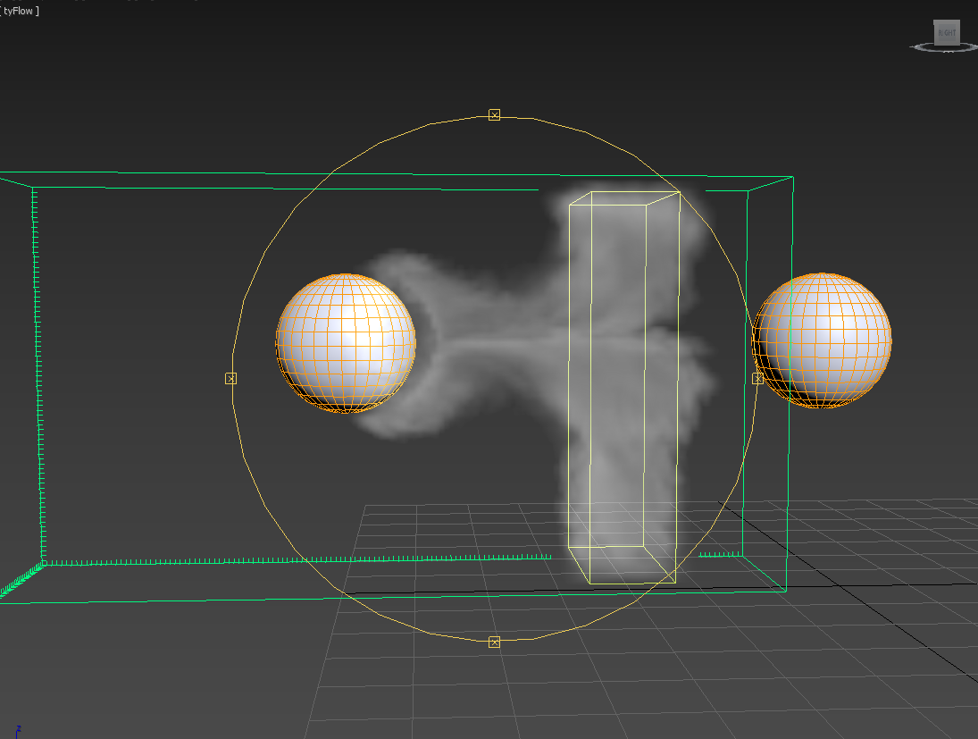

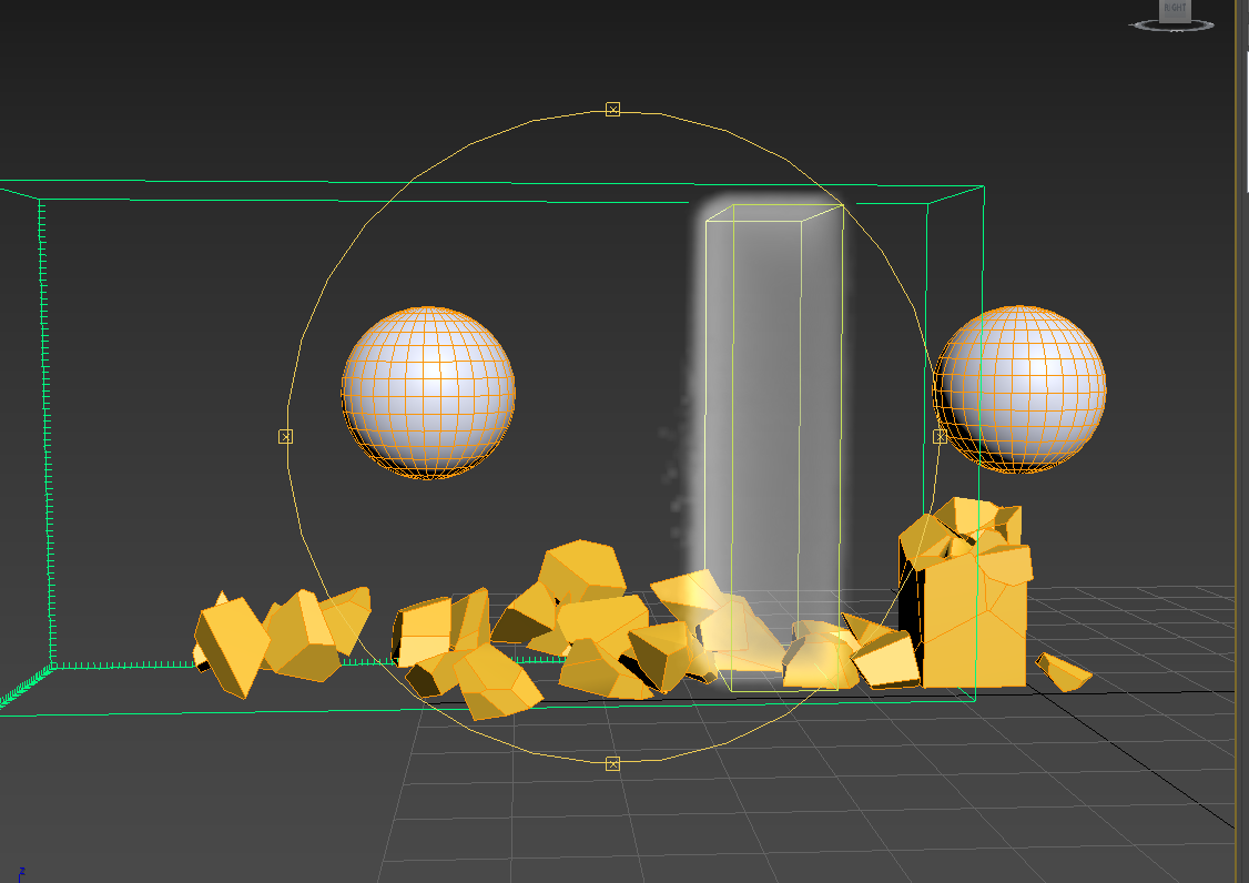

iv come across a problem with the interaction between TY and PHX
simple test destruction scene setup
i have a box that is voronoi'd and then a sphere collides with it.
now , PHOENX is emitting a simple column of smoke from a box (scene object , non-TYflow)
if i then simulate PHX with the just my TY collision spheres it works, but as soon as i simulate with my "destruction" and sphere it doesnt work.
also, if i export all my TYFLOW as scene objects it works as expected.
here are pics to illustrate, and also a simple scene setup
if u sim SMOKE with TYFLOW  EVENT 1 off, the Sphere effects SMOKE fine, if u switch it back on it doesn't

Works fine for me in Phoenix 4.0.
For prior versions of Phoenix, try disabling the particle interface in your tyFlow and see if that works...that might help to force Phoenix to detect the meshes of the particles. I think in versions prior to 4.0 the order in which Phoenix grabs meshes and particle interfaces was different...it might be treating your chunk particles as points, thereby preventing the meshes from affecting the sim directly.
