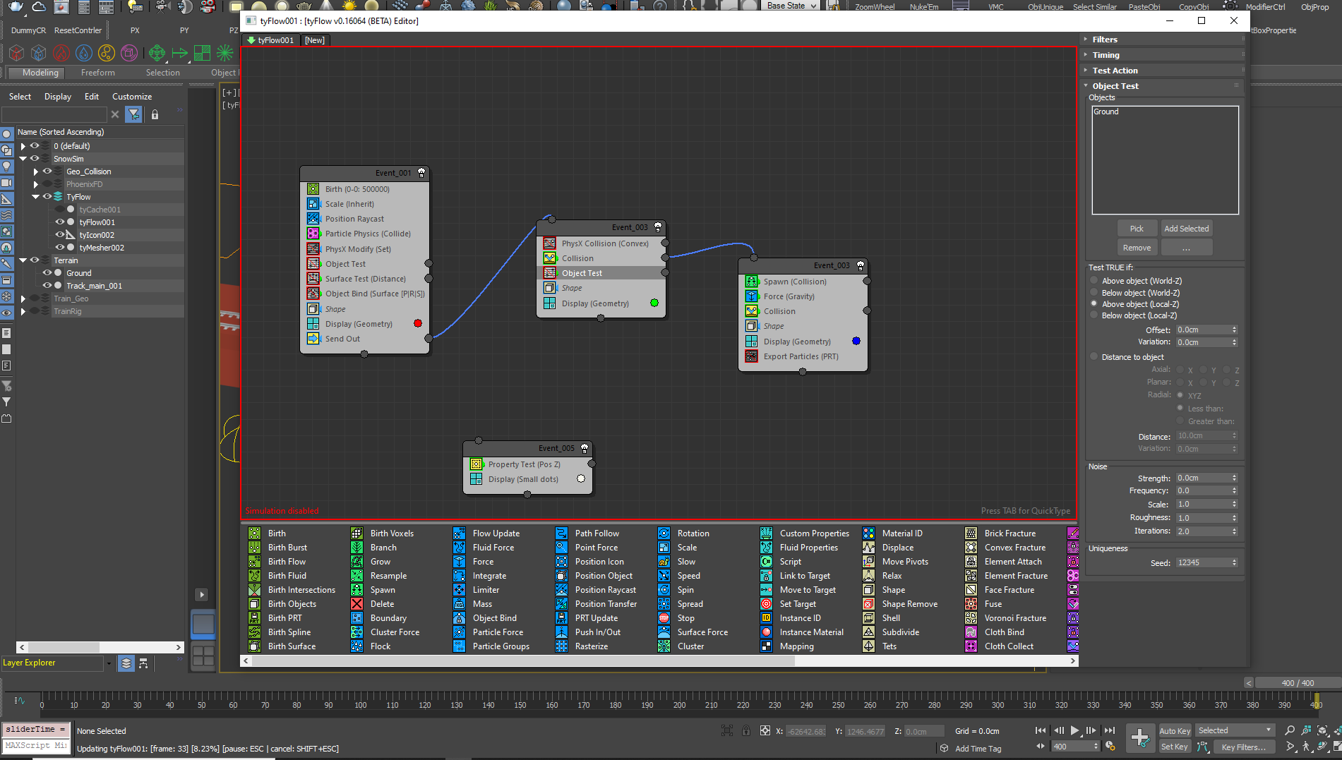

I have attached a screengrab below. Sometimes I disable the flow, move the time slider to the frame I want to see and enable the flow...

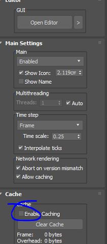

Did you disable the caching option in the tyflow object? If you disable this it will have to update all the calculations per frame and is very slow. If this is enabled it will save all those calculations in the ram and will enable real time scrubbing and playback of your scene. It can fill up a lot of ram if you have a ton of particles though, i can easily fill 64gb ram with a few million.
If you have a sequence that you want to save with the PRT/tyflow cache operator, but it has more particles than your ram can handle, you can disable the cache in the main tyflow object settings. It will have to recalculate every frame (before it saves the cache on HDD) however it will allow you to scale things up higher than you normally could. This is very useful when you are partitioning caches for a large simulation such as a krakatoa render. (tens or hundreds of millions of particles)

The more frames you need to save into memory the longer it can take, but once it is cached the timeline scrubbing should be smooth. Is it trying to recalculate those later frames even after it has done it the first time?
If you run out of ram while its saving caches to disk it can crash max. If you disable the playback caching (in the tyflow obj) it uses FAR less ram for the simulation while you're saving to disk because its not accumulating all the params of the particles into your ram for every frame. The downside is if you move the timeline at all it has to recalculate that frame, but that is irrelevant if you're saving a scene to disk. The playback caching in the tyflow object is only really needed if you want to be able to scrub the timeline back and forth without having to wait for it to update.

I've  looked your file (i7 - 32GB Ram), and indeed it's very slow.
But I wouldn't blame Tyflow here, but rather the workflow. For example, I saw you placed 100 bind connections per particle.
I hardly know the case where you need more then 10.
Your voxels are very very small, and I understand why you used custers (you probably wanted organic sticky snow), but when I visualize cluster, it doesn't make much sense to me (they are grouped at the middle).
What I'd suggest you to do, is to create a "small res" Tyflow sim of snow with voxels, and then use another flow (and birth flow) to increase particle numbers.
