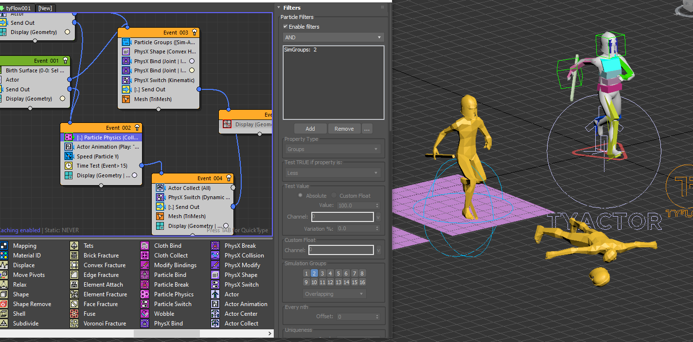

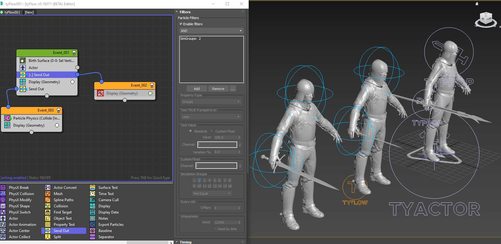

Am trying to randomize actors and its working fine but I want to use particle physics for simulation , now without props it works fine with one collision sphere but with props I get one for each. am using groups to differentiate them from bones , now I know why is this happening but am asking if anybody knows a workaround or an another way to do this.
Also TyProb don't generate a skin mesh which might solve my problem here.
Solved, basically I had to differentiate props from bones in all events using groups and send it to disabled-display event.
