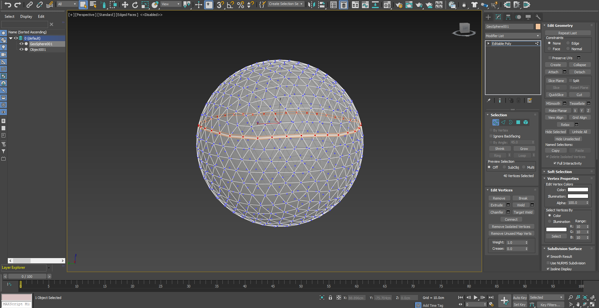

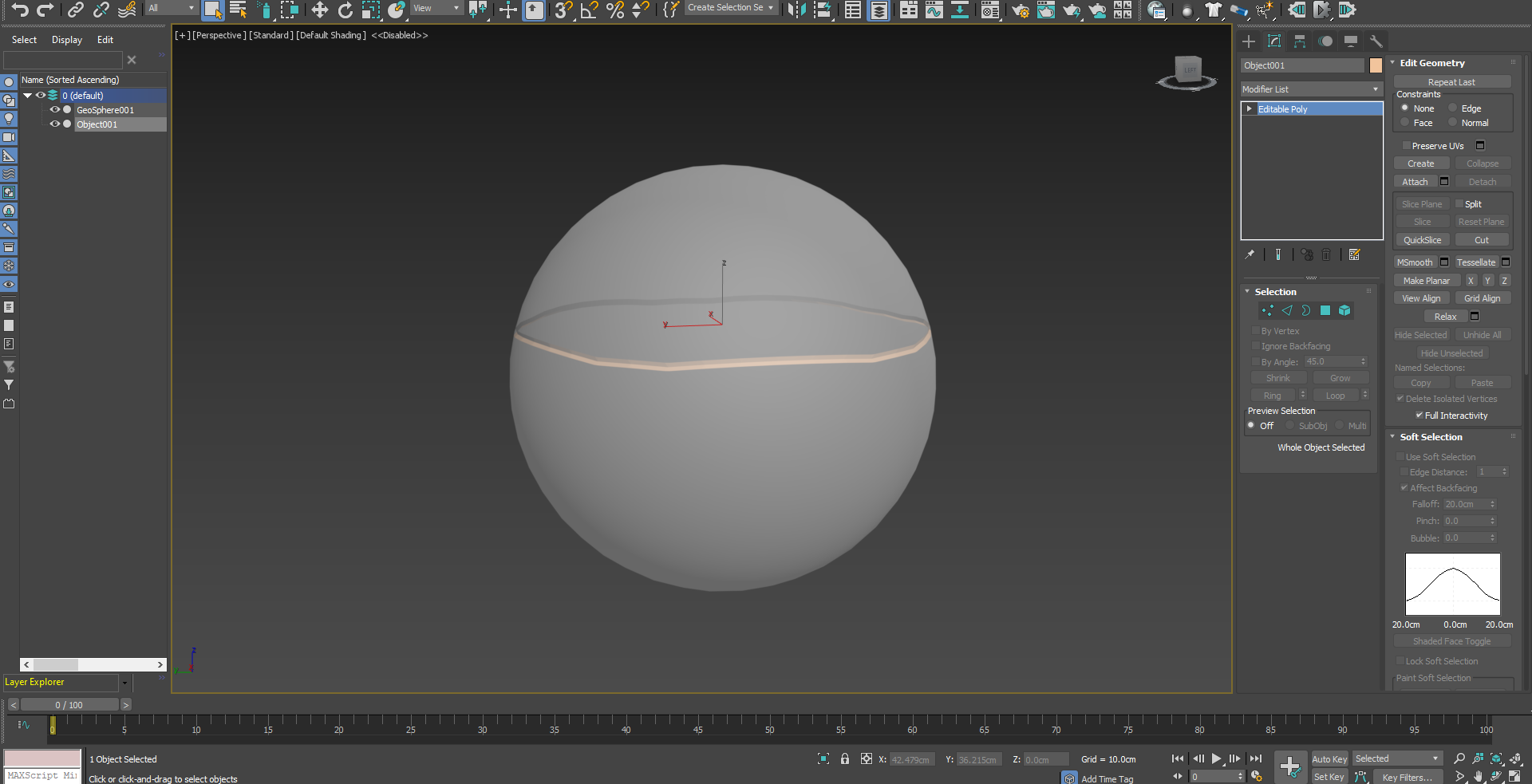

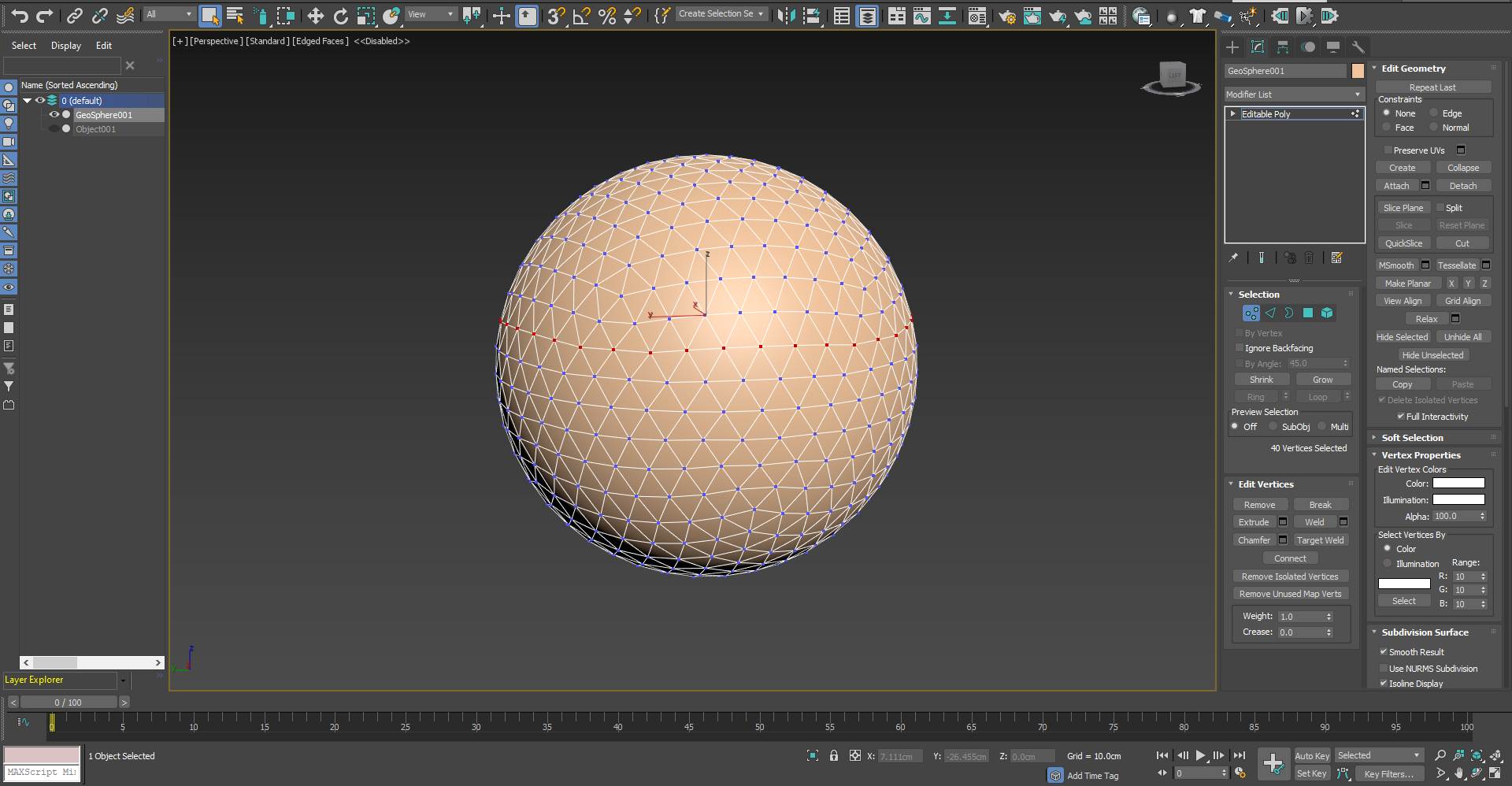

Right now this is my approach to achieve what i described earlier.
On the 1. pic is a geosphere, that i want to control through the marked verts. Binding them to another object while the rest of the geosphere is under the influence of the particle system.
2. and 3. pic i created an mesh that will be disabe particles through a surface test and send them to a bind object event.
So is this how to do it the right way? Is it the most efficient mehtod?
