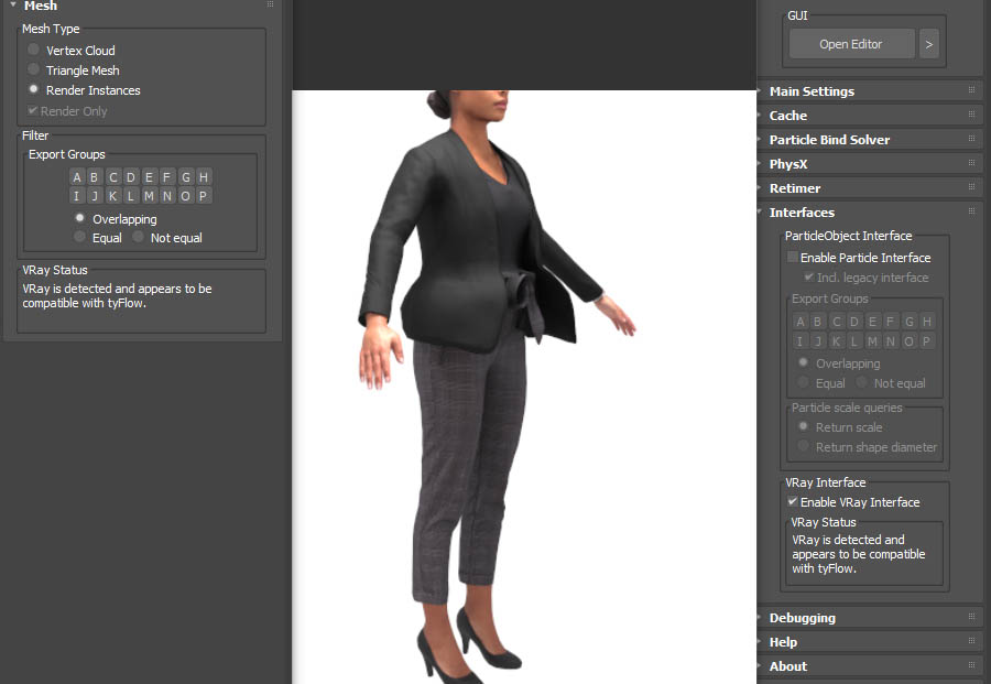

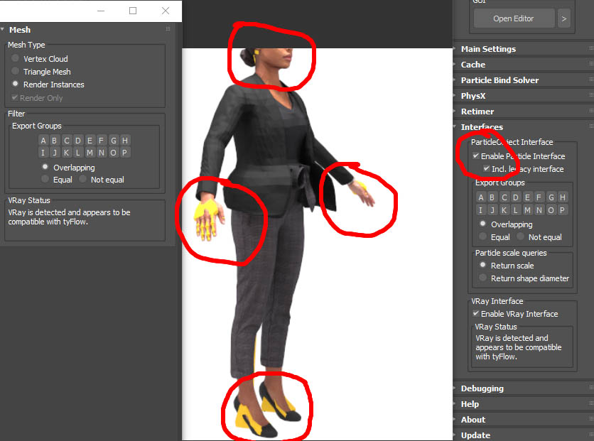

Hi, one more thing (almost on the subject:-)
First; Tyflow and Redshift are a beast of a combination i must say, unbelievable speed and fun!
But when i render a tyactor with enable particle interface the characters bones gets rendered.
Turning off enable particle interface hides the bones (as it should be i assume.)
See attached render. I posted in redshift forum as well.
I use tyFlow_016084 (latest to date) and redshift_v3.0.18
Best /nico
Don't disable the interface, disable the Mesh operator. That's what's triggering them to render.
(04-29-2020, 05:33 PM)tyFlow Wrote: Don't disable the interface, disable the Mesh operator. That's what's triggering them to render.
Ok! That did the trick!! big thanks!!
