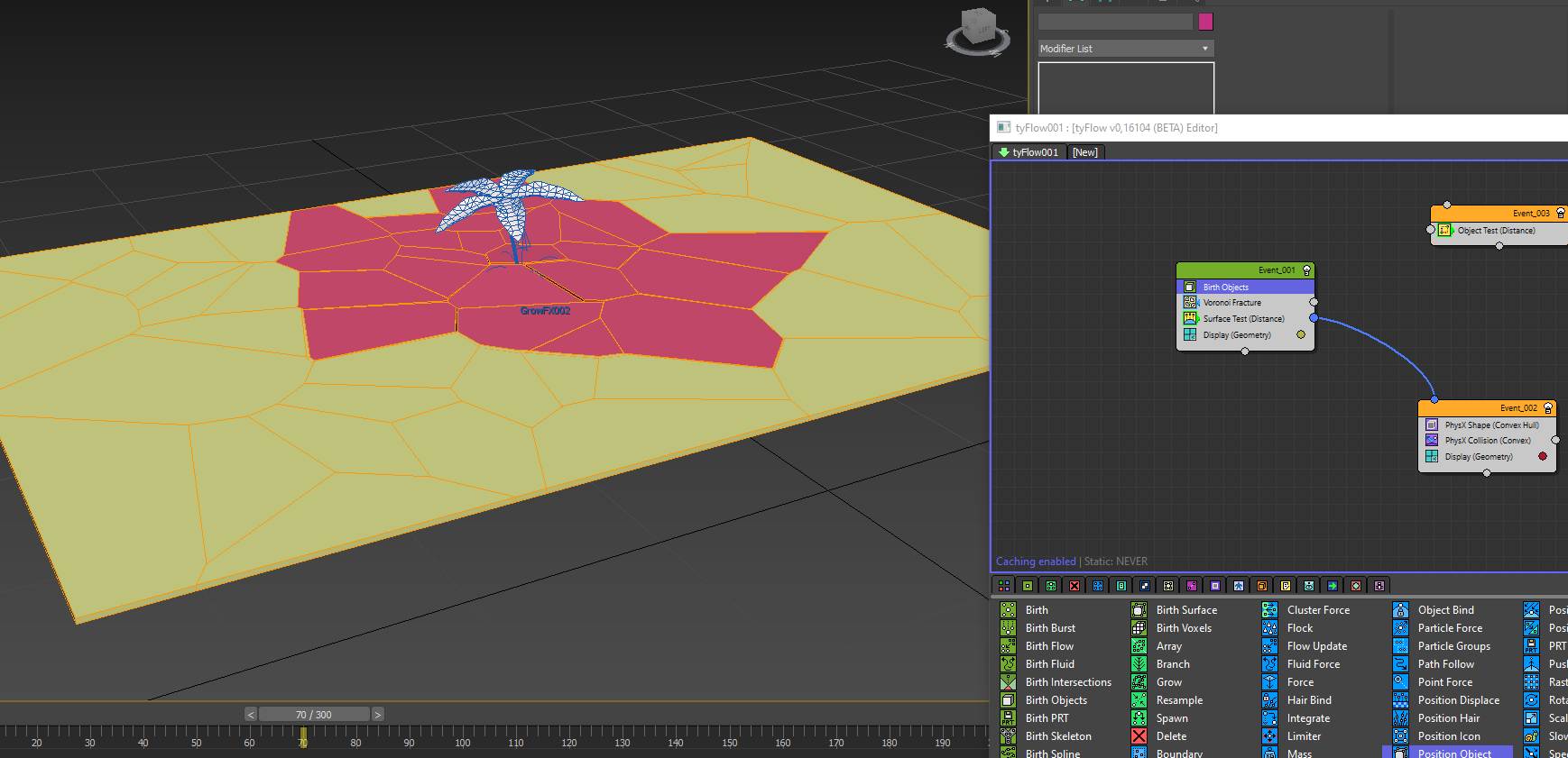

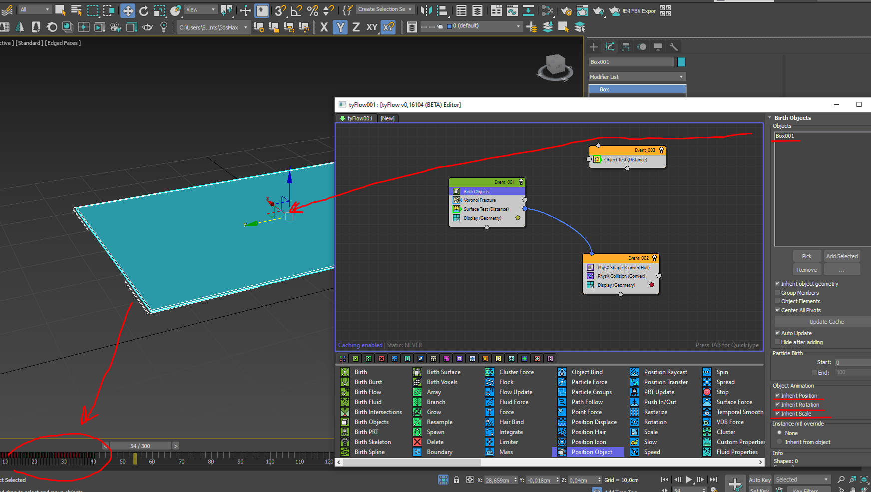

I need a shaking ground, destruction by the growing flower.
I animated the destruction but tyFlow does not inherit the shaking of the reference box
Add object bind operator, and pick your original box.
