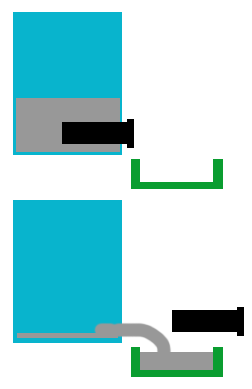

Hello, this seems simple but here I am new and trying to find similar examples to what I'm trying to do. I need to fill an oil tank that has a large plug that protrudes into it from the lower side. The plug will get pulled horizontally and particles drain into a tray.
I've used birth>position icon/volume and added a collision on the plug but the particles intersect and fill the plug as well as the volume in the tank.
Any pointers for how I can fill a static volume around a movable object?
Below is a very crude drawing of what I'm trying to do.
Thanks for any pointers! I'm learning as I go Smile

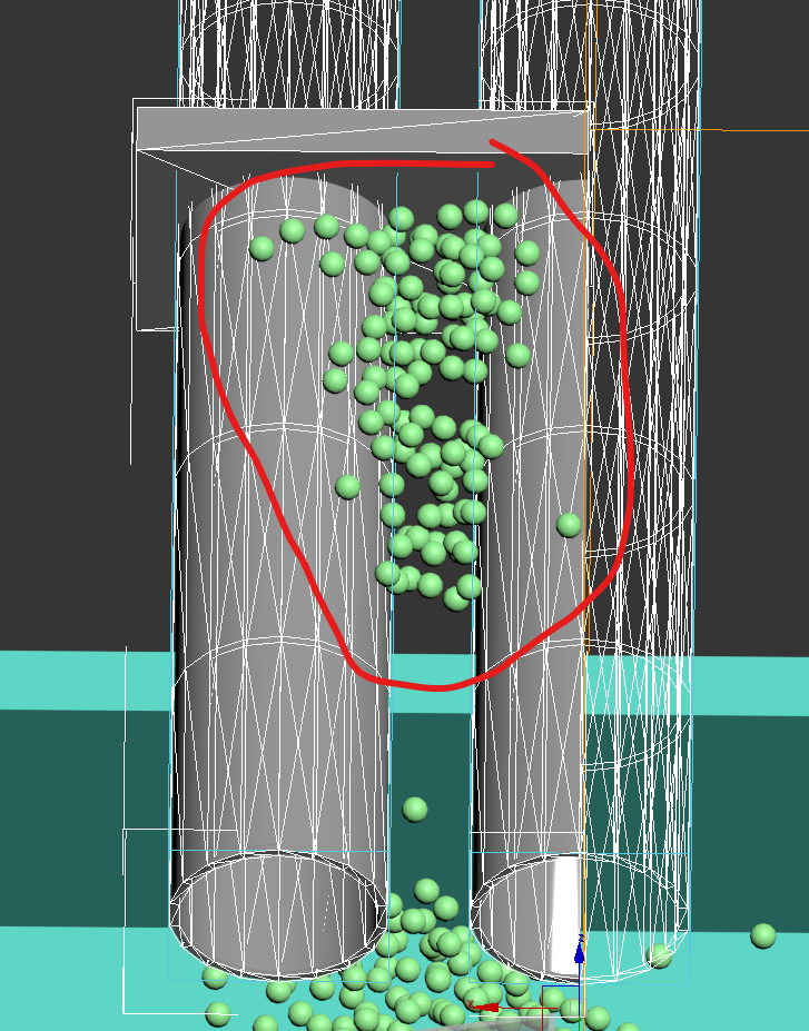

One observation shown in the attachment below is that some of the voxels are floating in the air even when the plug has stopped and they never drop. I tried reducing friction and adjusting gravity but that didn't do anything. I'm showing the physx mesh hull and the plug beneath. Its not a big deal but thought I'd ask.
Thanks again, learning a lot here! Adding tycache next.
#13
Really hard to see from screenshot, what's going on, but they shouldn't hover above the ground.
Maybe they collide with default ground plane (you can disable default ground on Tyflow icon, under the PhysX)?
I have no idea really.... but I repeat... they shouldn't do that in any case.
